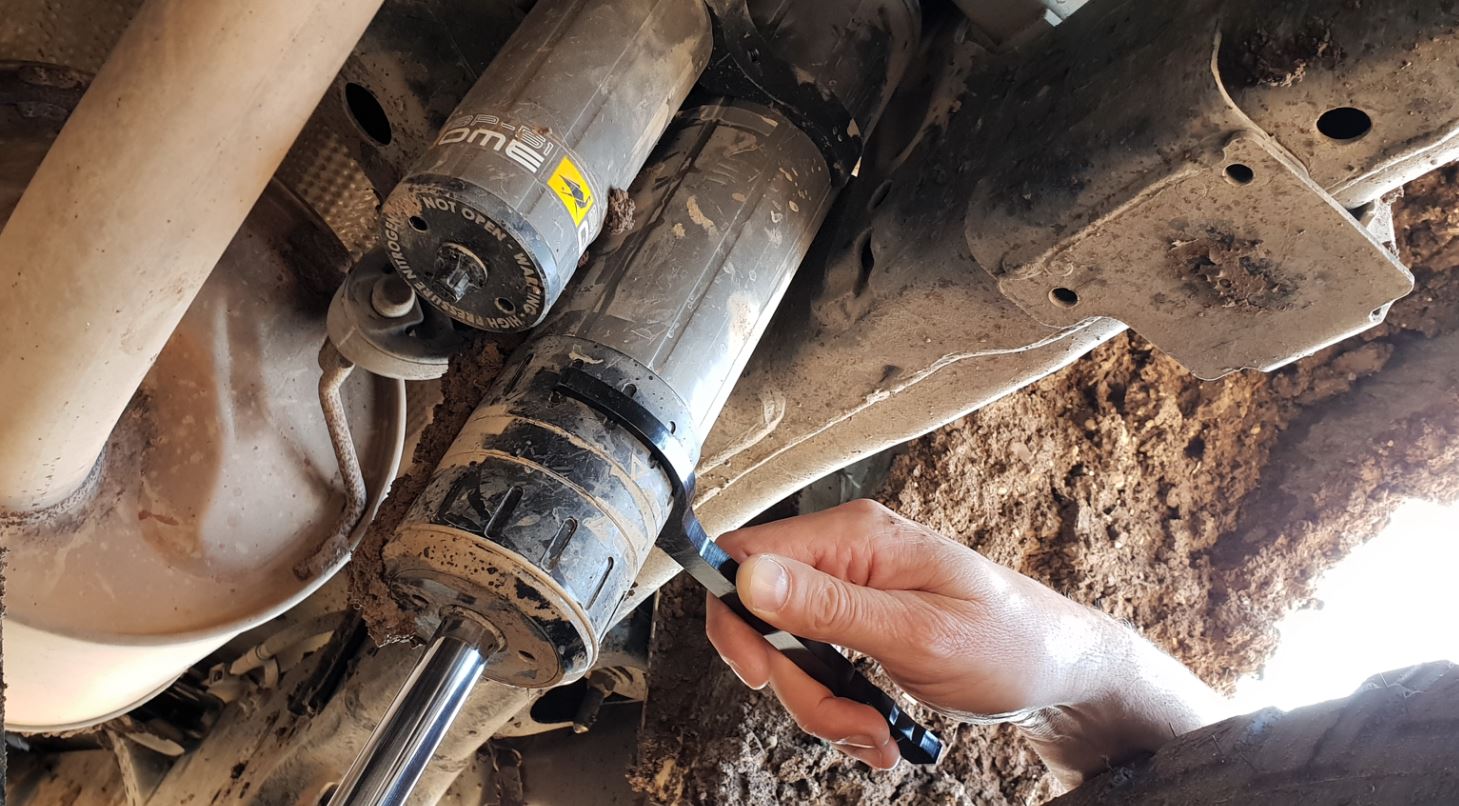

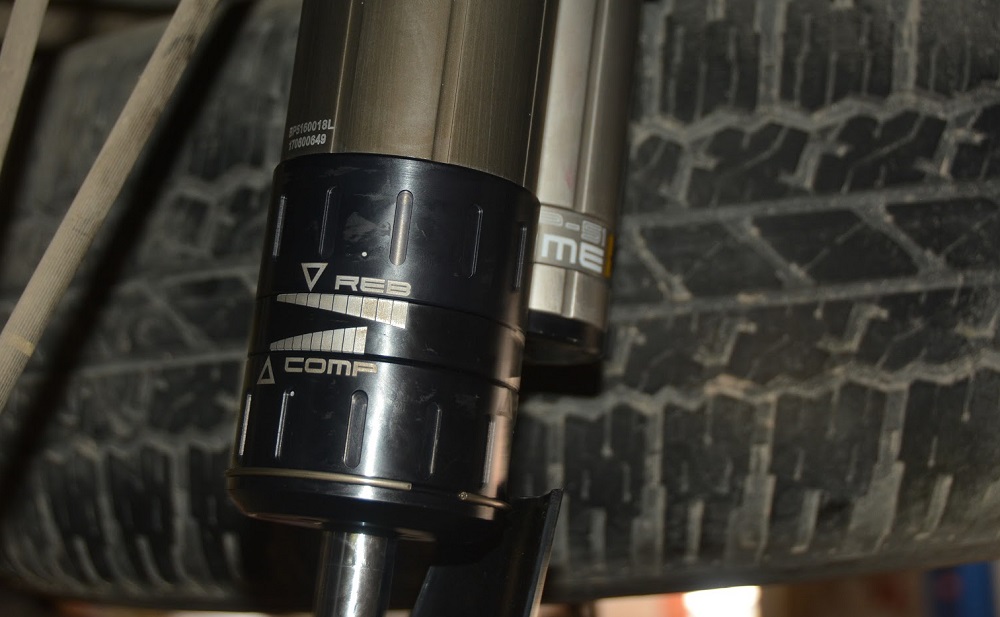

    : , 3, 4, 7 . - Bypass Tubes. , . , - (, Compression, "") (, Rebound). "" . - .
    , . , , - . , , , -, . , , , . , (Position Sensitive) (Velocity sensitive). , .
    ? . , ! - , . . 200 ", .

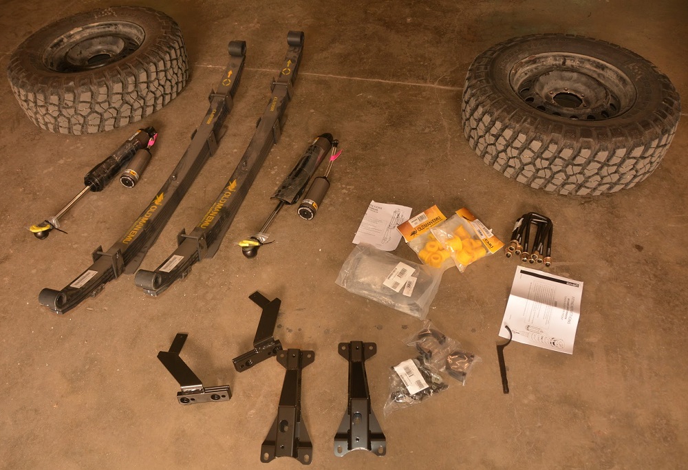

    ARB . , --. () , . , , . (8 ) . , ... , . BP-51, ByPass, -51 - 2 '.

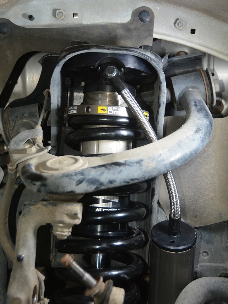

    OMB BP-51 Revo
    OME, BP-51 -, . , . , , , . BP-51 - .
    . , ( - ). (/, , ). . 50 " . , . , , . , " " .
