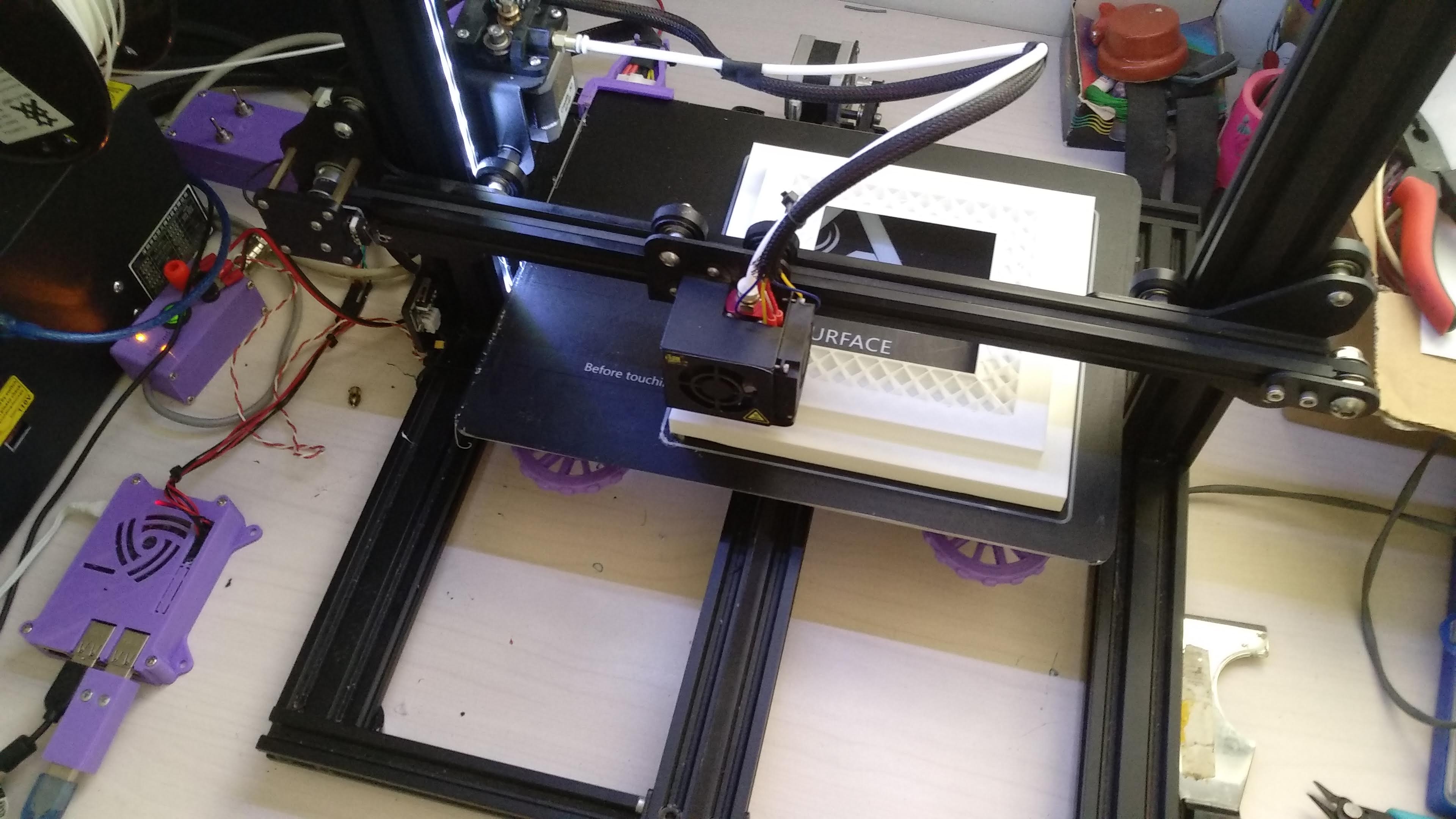

https://imagizer.imageshack.com/v2/1...924/yrXvia.jpg

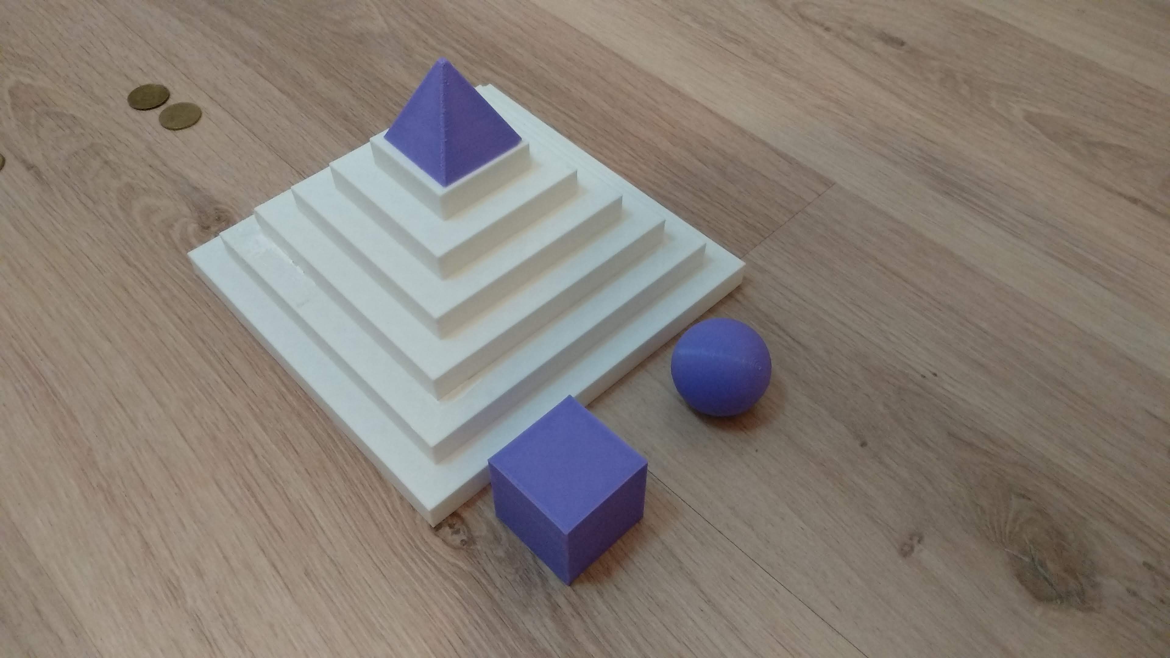

/https://imagizer.imageshack.com/v2/8...921/B6MSEW.jpg
