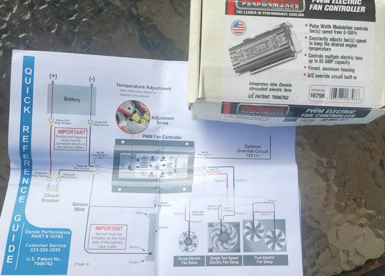

    . 0 100 .. derale.
    https://derale.com/product-footer/el...r/16796-detail

    (+2 , ) 70% .Click image for larger version.

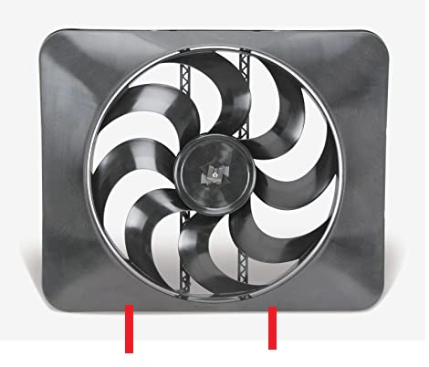

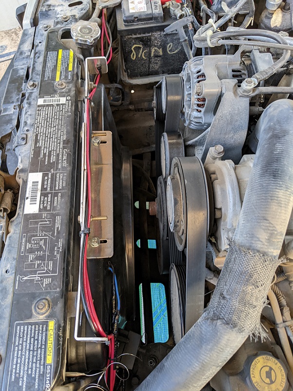

    : ZJ 96 , 5.2L , V8
    : Flex-a-lite 180 Black Magic X-treme 15" Reversible Electric Fan
    , , 50% .
    2 , 2 (12 " ) .
    2 .

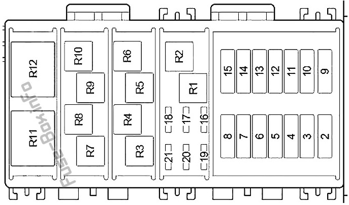

    , 90% .
    "" , 18 - ( )
    , , 18.
    - , 100 .
