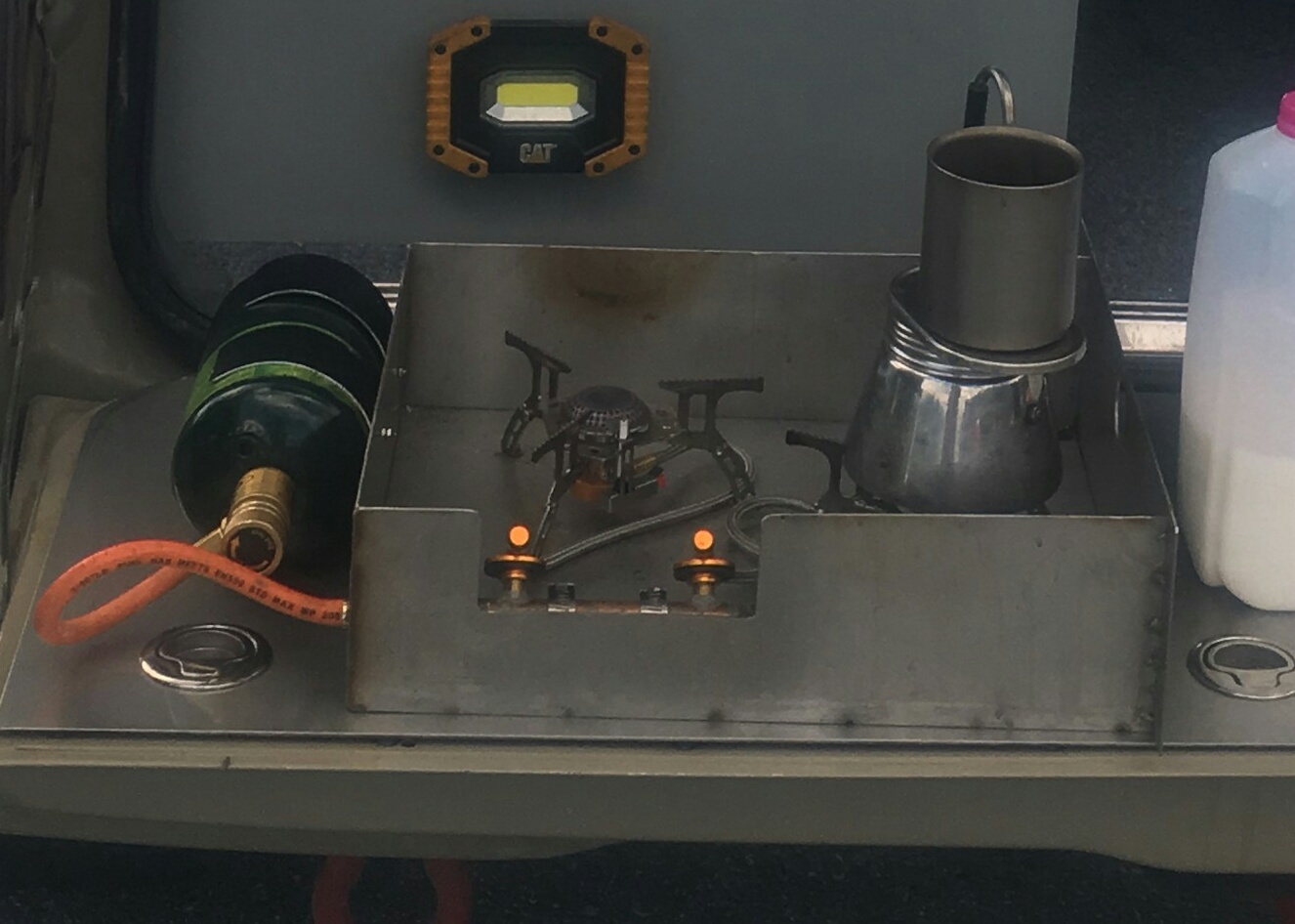

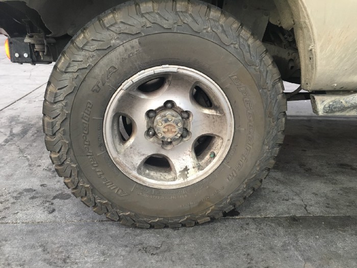

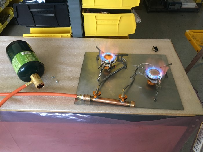

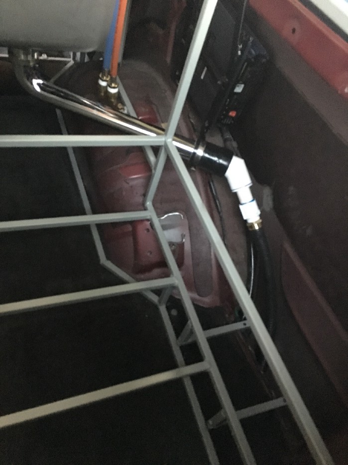

    עניינה אותי במיוחד התמונה הזאת:
    יש כאן כיוון מעניין לכירת שטח כפולה תוצרת בית.
    הגזיות הנל נמכרות באתרים הסיניים בגרושים.

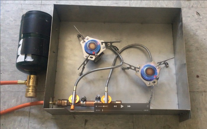

    ואכן כמה פוסטים אחרי, מצאתי את זה:

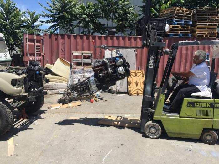

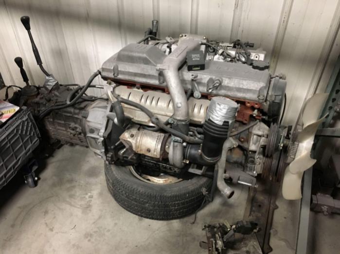

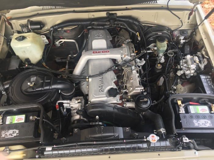

    המשך החלק הראשון מהבלוג מובא כאן בשפת המקור (אנגלית):
    Searching for the right engine was a long process -we’re talking 2 years. After exhausting eBay and Craigslist, in December 2017 the engine was finally found through the North America Land Cruiser Community (through Facebook). The engine/drivetrain came out of a European HDJ81 Land Cruiser and was sent to Valley Hybrids, a shop in Stockton, California that specializes in diesel engine conversion for Land Cruisers. They replaced most of the external parts, rebuilt the injector pump and injectors, and did all the checks to verify that the engine was in excellent running condition. They also rebuilt the 5-speed transmission. The transfer case was converted to part time 2WD/4WD from all time 4WD in order to get even better milage on the highway. They have done an amazing job. We could have not chosen a better shop.

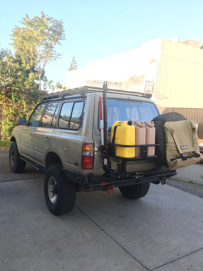

    Meanwhile, “back at the ranch”, the vehicle was undergoing more changes. The bumpers were upgraded with more rugged units that can accept a winch and a spare tire in the back. The front seats were refinished with new leather and seat warmers. The two rows of rear seats were removed to allow space for a kitchen and bed.

    The electrical and fuel systems had to be converted to the diesel engine and the transmission hump had to allow for the new manual shifters. The vehicle was then painted with a ‘sand’ color to blend better with nature.
    In June, the engine was completed at Valley Hybrids. We borrowed a truck and brought it from Stockton to San Jose, California. On a hot sunny day in July the engine was finally put into the vehicle. Since this engine was designed for this Land Cruiser model in other countries, little metal work modification was required.

    The big test was a road trip from San Francisco Bay Area to Tempe. The vehicle was taken on a 2000-mile trip to Arizona including 4WD trails in Sedona. It drove beautifully and got 24 mpg. There were no mechanical issues. The last day it was driven over 1000 miles with one gas stop for 10 minutes.

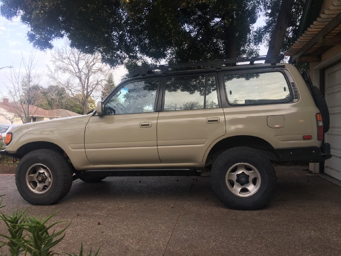

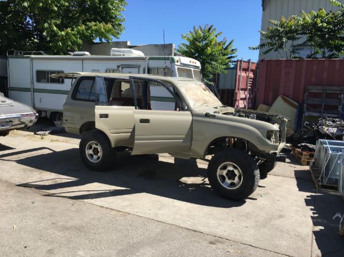

    כנראה זה המראה המקורי לפני השיפוץ:

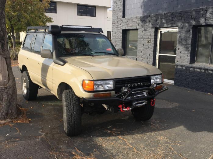

    ברירת מחדל תגובה: Overland Land Cruiser in Alaska

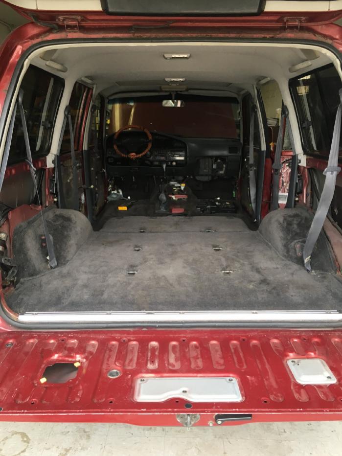

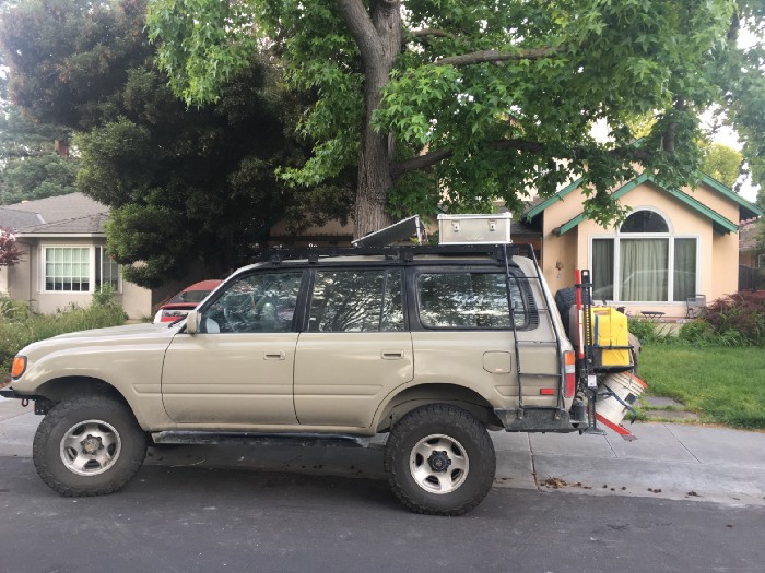

    This is the original car 15 years ago. It is 1993 FZJ80 with 250000 miles.

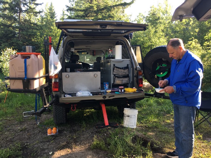

    הפרק השני בבלוג עוסק בבניית המטבח.
    קישור למקור - https://medium.com/@ofer.bruhis/buil...-2-d05225f1b8a
    מתוך עצלות אני אצטט את קטעי הטקסט בשפת המקור (אנגלית) ואטמיע כאן את התמונות.
    New year 2019!

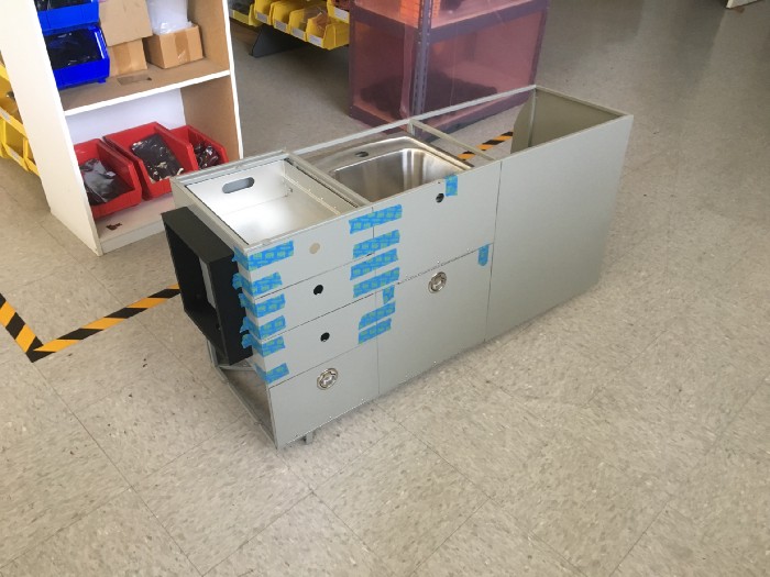

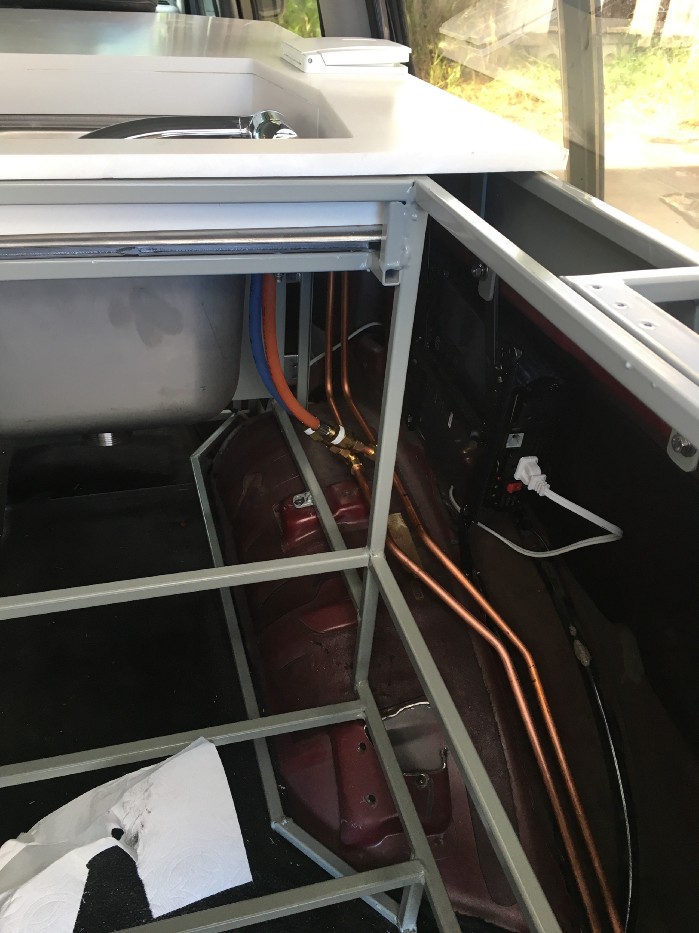

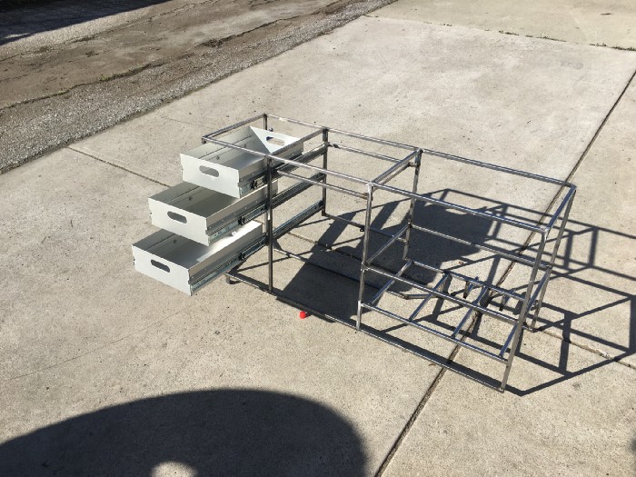

    Our search for a sink and faucet zeroed in on a Kohler K-3349–1-NA. We liked it because its a sturdy 18 ga model, small and deep. The faucet will fold in to the well.
    The cabinet frame is made of 1/2" square tubular steel frame. That would be covered in the future with aluminum sheets and powder coated gray to match the interior of the car. We sized the frame to fit the fridge.

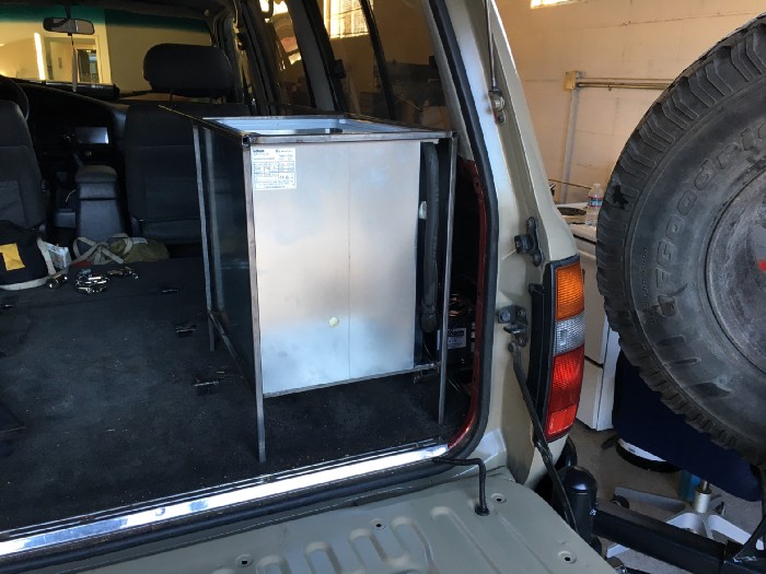

    The fridge fits nicely with the compressor tucked into the wheel well.

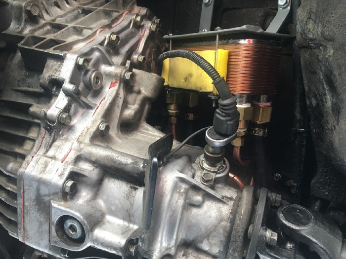

    The Kohler sink heat exchange unit for the hot water system. We will have to find a place in the vehicle for this unit.

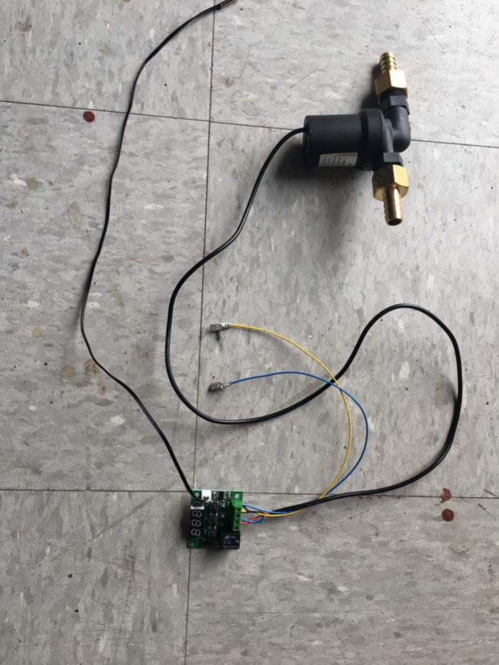

    The water from the ‘hot water tank’ gets circulated with a pump that is being controlled by a thermostat. A switch on the dash will turn on and off the pump.

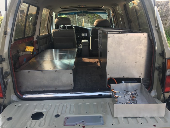

    We had issues with space for the stove. We ended up building a stove from two camping stoves and some machined brass pipe parts. The connection was used from a torch welder and it hooks to a standard coleman propane tank. The stove was assembled and tested. It will require a wind shield and is designed to fit in a drawer under the fridge when not used. We can pull it back to cook by the tail gate, or to remove it completely and place it on the counter top for cooking in wet or cold weather.
    Our next task is to find drawers and finish the storage unit behind the front seats. Last we will build the couch that turns into a bed.

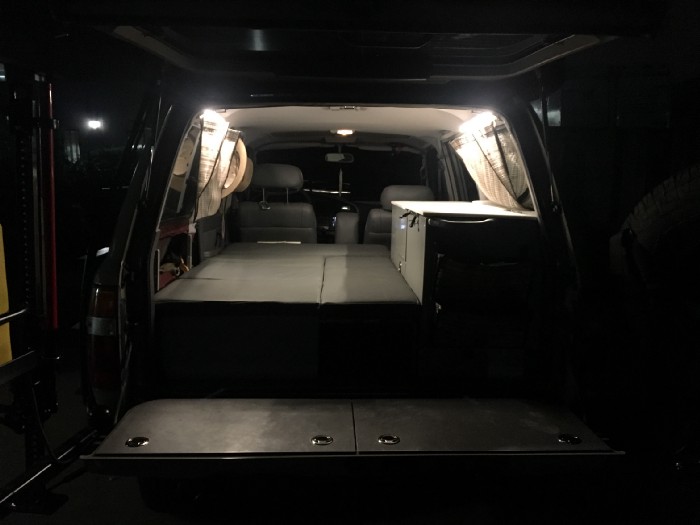

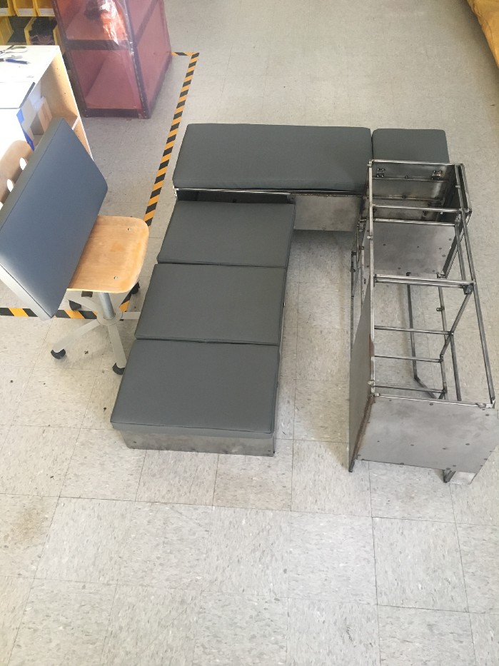

    הפרק השלישי בבלוג של עופר, עוסק בעיקר בריהוט הפנימי של הרכב.
    קישור למקור - https://medium.com/@ofer.bruhis/buil...3-62f0545e0d8e

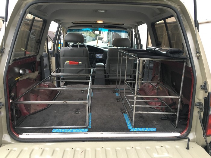

    We have been busy. We leave for Alaska in 6 weeks. Not much time left. Rain has kept us from working, but we made some progress. We have been working on the frames for the kitchen, storage and bed.

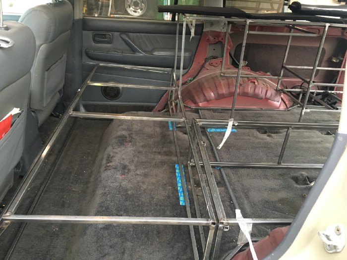

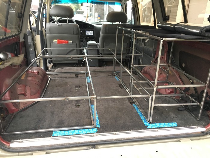

    The storage compartment will be behind the front seats with 3 aluminum lids that hinge. We are not sure if we want this as compartments or one large storage that can be divided by boxes or storage bags. The two hatches on the driver side and center will have 2" cushions and will be the upper part of the bed.

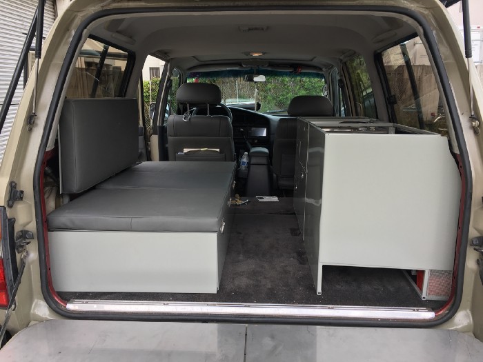

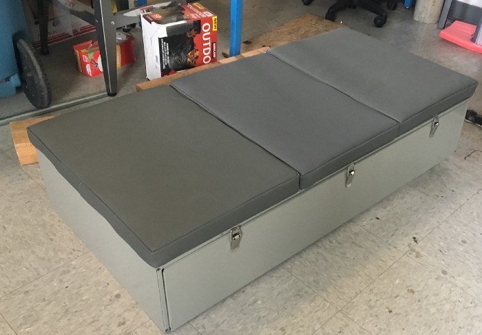

    The lower side of the bed will be a bench that has a slider part that opens to a twin bed. The bench will have 3 cushions so that passengers will be able to sit on a bench seat in the back. They will have leather on top to match the front seats. The bench also has a storage area underneath.
    There will have to be some latches to lock it in place. We will also install a back cushion for the bench, that will be removable and used as the part of the mattress that covers the slider part of the bed.
    These 3 frames will be attached to each other and to the vehicle itself with screws. They will not be permanent, and can always be removed.
    We ordered SkyCart aluminum drawers and installed them with extension glides. The bottom drawer is a bit lower to allow taller pots to fit in.

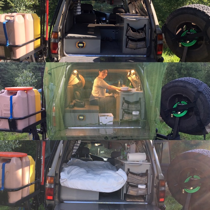

    Stove work is done and it has been tested.
    The stove will slide under the Fridge. We can pull it out and work on the tailgate or on a table. If weather gets bad, we may be forced to cook inside.

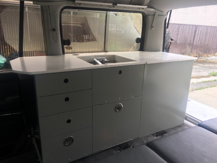

    Kitchen cabinet got aluminum doors. This is 6061-T6 0.1" thick. All metal work will be powder coated.

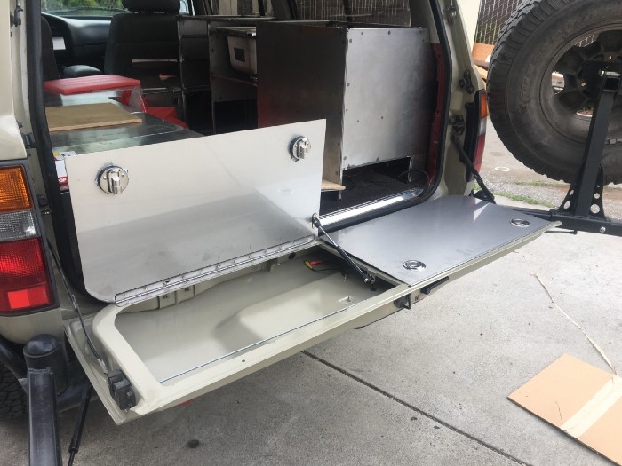

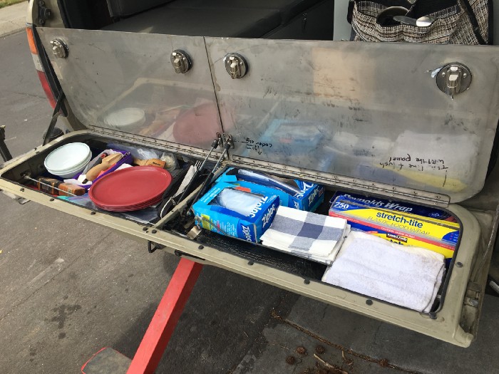

    The rear tail gate has food grade stainless steel plates with latches so that we can store all the recovery gear. It is a bit heavy, so when opening it, care must be taken.

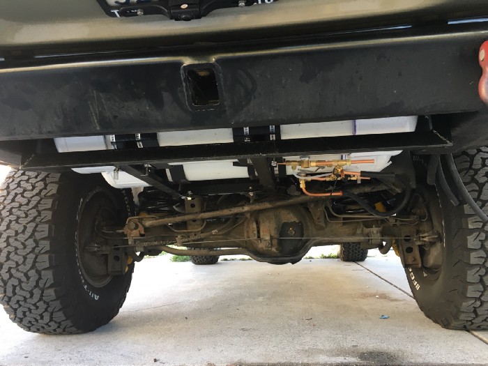

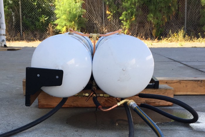

    The bracket for the water tanks that sit under the vehicle is done. Water tanks are 8" PVC schedule 40 with caps. Each tank provides 30 liters of water. One of the tanks will be hot water. A circulating pump with a thermostat will run the water through a heat exchange unit with the radiator coolant. The compressor will pressurize the tank so that water will ‘climb’ to the faucet and shower. Ha, yes, the shower…

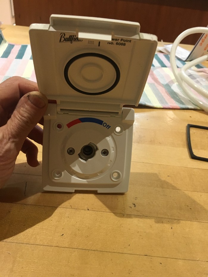

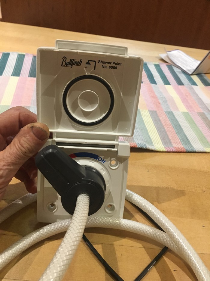

    The exterior shower unit is a Bullfinch shower head. The unit is well made, and very compact. We will let you know how clean we come out.
    The shower head plugs in and has the handle integrated into it.

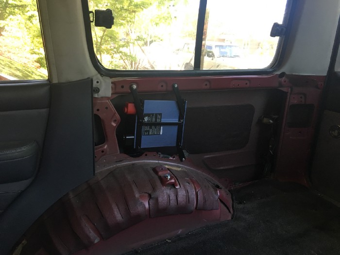

    Also, the electrical panel is being assembled. Solar panel controller, 110 VAC Converter panel, main switch panel, thermostat controller, 110V plug and fuse box. A main disconnect will be added as well.
    The 110VAC 1KW converter was mounted inside the wheel well to save space.
    I guess we will post this public, and continue working…

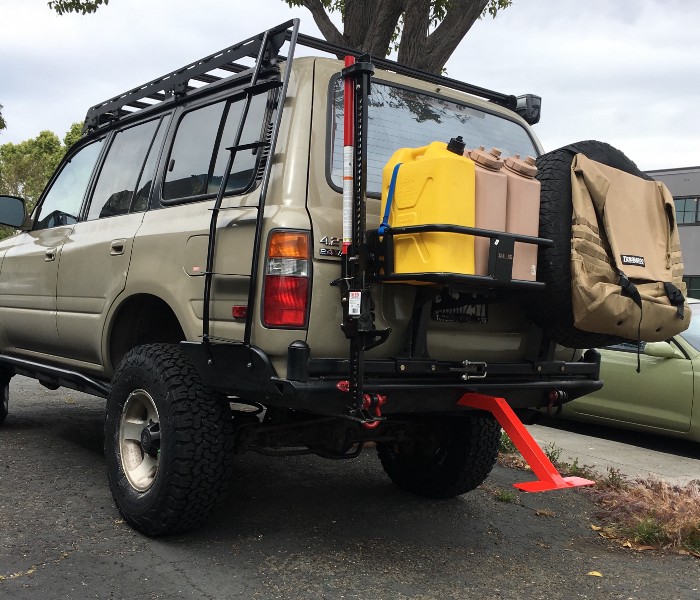

    We also added a rack from 4x4 Labs. Luke is an amazing guy and a great designer. It supprts 3 Jerry Cans and a High Lift. The roof rack is made by Prinsu Design in Idaho. It easily mounts on the vehicle and spreads the weight. Very well desined!!

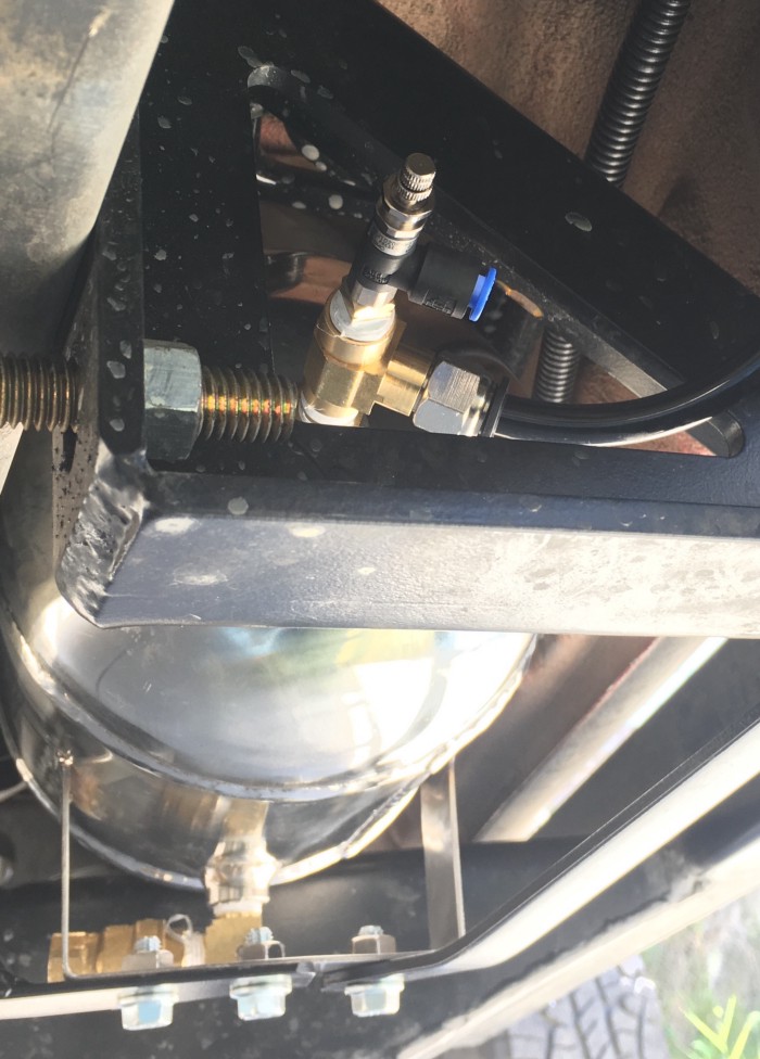

    The air system was installed with an ARB compressor and a 1 Gallon air tank. A pressure reducer was required for the air system that pushes the water up out of the tanks to the faucet and shower head. We are fighting gravity all our lives…

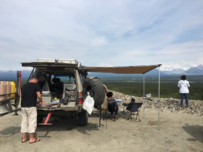

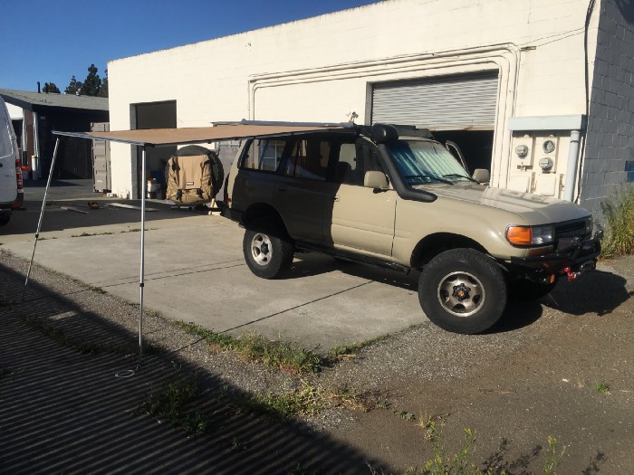

    The ARB awning was installed with custom made brackets.

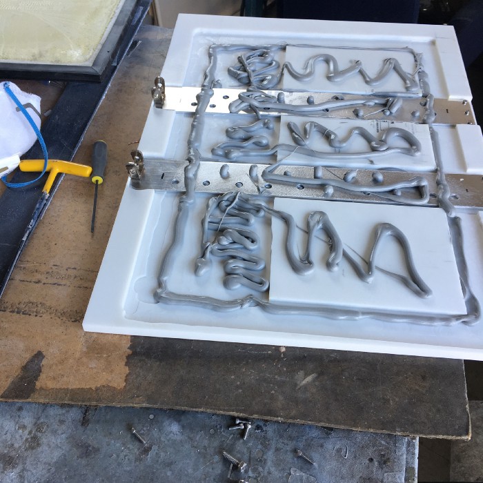

    The finished panels for the drawers were installed using 100% silicon to glue them. We hope it will hold.

    The heat exchange was mounted above the transmission. There was just enough space for it. Silicon hoses to the radiator water. Rigid copper for the drinking/shower water.

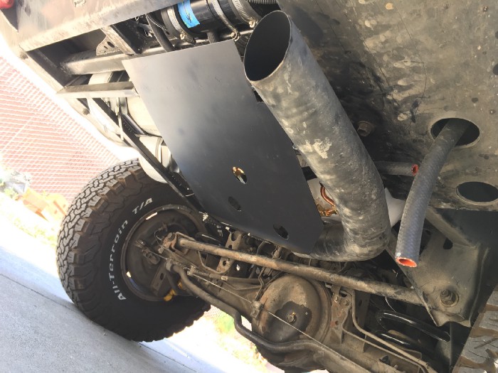

    We did a test of the hot water system. Ran it through a 1 gallon container. It took 10 minutes to bring it to temperature. Seems like we will have hot water after all. The original pump that we chose was not self priming, so we chose a different pump. We used an old prius battery to run the pump.

    We used an old Corian slab to build the countertop. It takes a long time to get everything accurate, but once it’s assembled it looks great. The material is easy to work with and the glue lines are almost invisible

    We used 3/8" copper pipe for the water system. Most used compression fitting, except in a few places that used a silicon hose with clamp to relieve the stress of the vibrations.
    The lid for the fridge gave us a bit of a problem. For a $1000 fridge, the quality of the lid is not great. It just sits on the top of the fridge and is made of molded plastic with a sheet of Formaica on top. We figured that securing is a must, so we used removable hinges on the back, and rubber latches in the front. All this had to be integrated into the lid and a Corian on top of it all. It was a time consuming task.

    Interior lights were tested with the ‘bed’ opened.

    The layout for the water tanks was done before construction.
    The water tanks were finally finished after a pressure test, and installed under the vehicle. We used 8" PVC pipes and they provided 9 gallons each. It heats 9 gallons to 150F in 18 minutes when the engine is running and warm.
    We added a protective plate for the plumbing.

    The circulating pump was installed inside a PVC pipe to provide some protection. It was installed in the rear bumper.
    So the setup for the three modes of the car — drive, cook, sleep are below..

    We planned the route so most roads would be traveled once starting and ending in Palo Alto, CA. Dashed lines are done in a ferry, green is the return route.

    The following night was Lake Inga in BC. The kitchen/water system supported 2 couples and worked well. We placed a bucket under the sink drain, so it will not create a puddle.

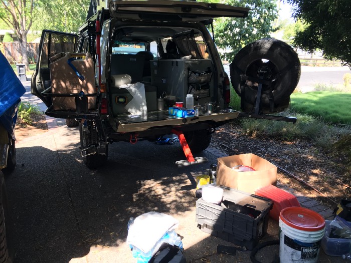

    The process was, open the back, pull the stove on the tail gate and cook dinner. The Jerrycan in the back was handy to quick wash. We installed a faucet on the bottom of it, so it would be easy access. The kitchen was all set in the tail gate, except the pots under the sink.

    The setup seemed to be working great. We could get food ready in 20 minutes with the table set up and the awning open.
    And… coffee in 6 minutes while some of us get to rest.

    This wheel has done 5000000 revolutions.

    מדהים!
    ממה בנוי הריהוט? איזה פרופילים אלה? וממה עשוי החיפוי?
