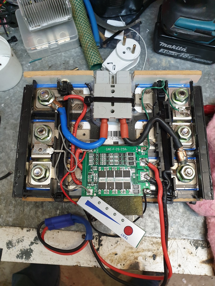

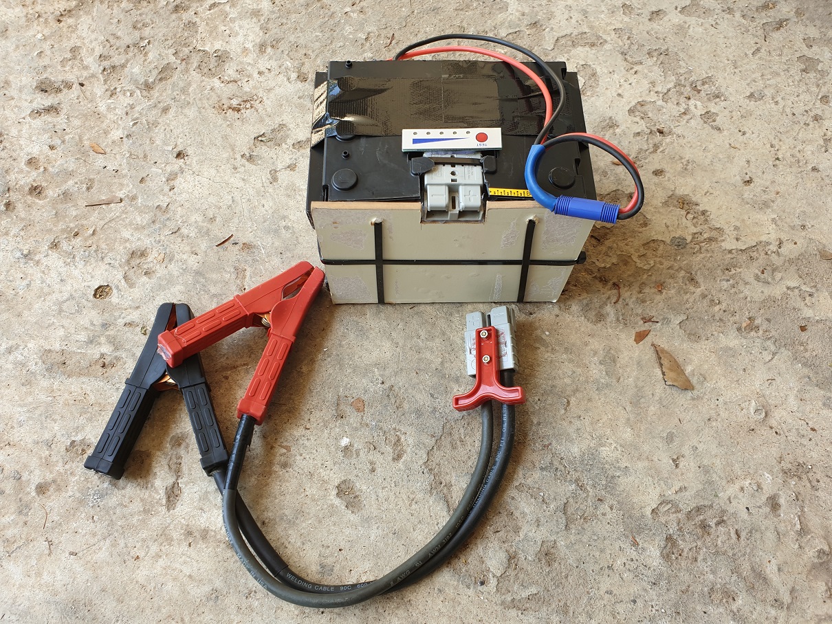

    , , , , ( 8), .
    12.6V , ?
ID:	125513Click image for larger version.
