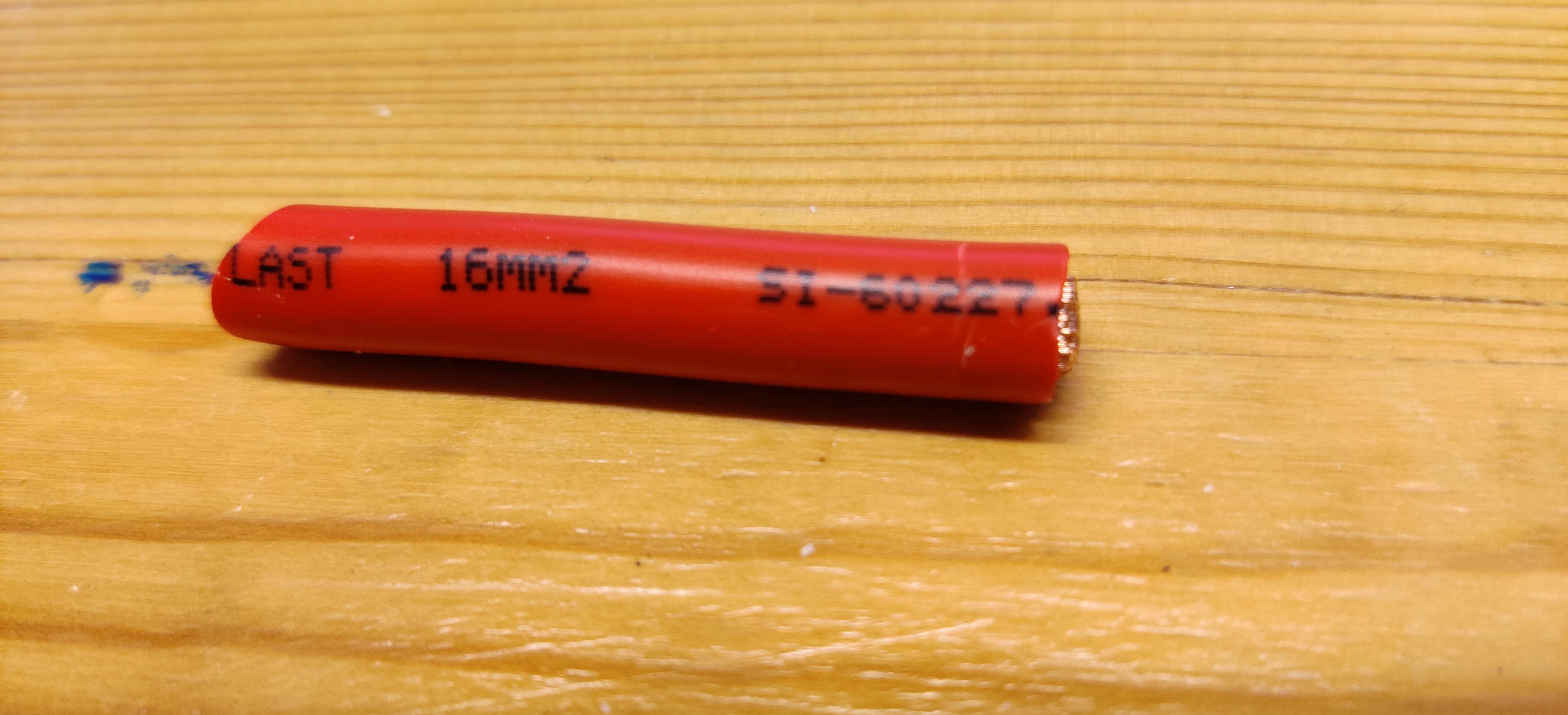

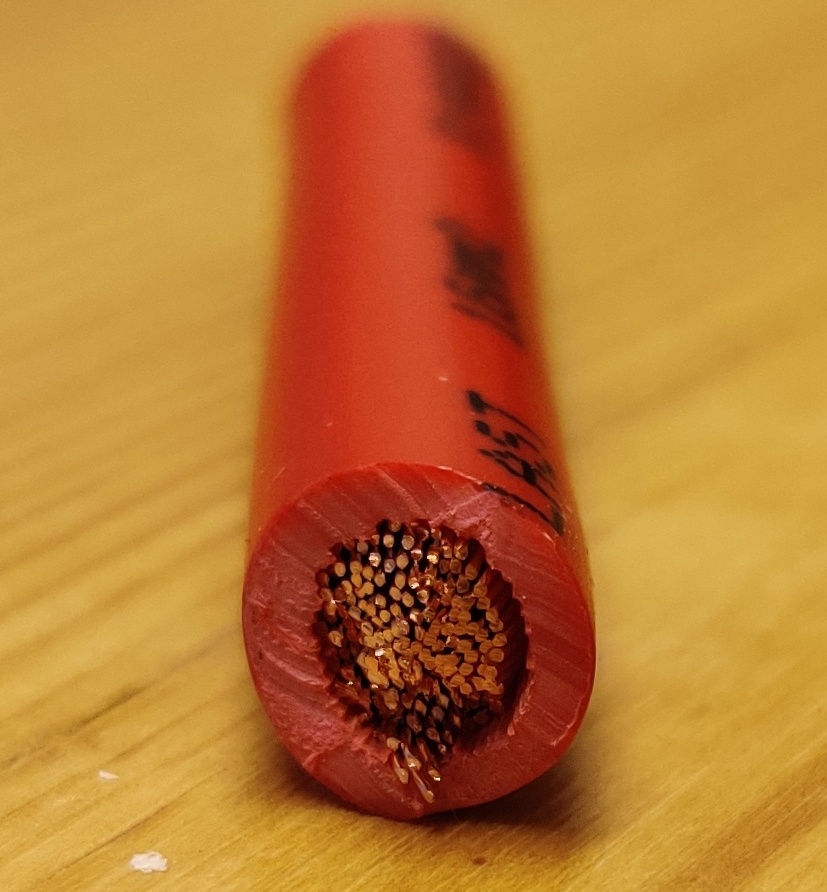

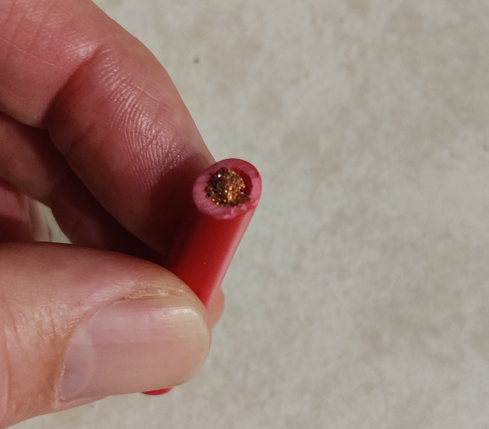

    boaziko's Avatar
    Aug 2004
    562
    10 " , 16 ".
ID:	129183Click image for larger version.
ID:	129184Click image for larger version.
    (, awg. .. , " ?)
