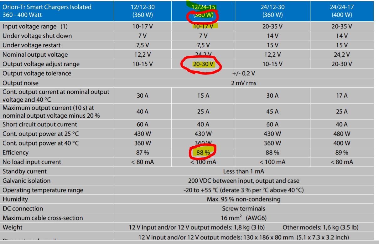

    , DC-DC 12 24 (Lifepo4).
    VSR ( ) .
    Jun 2008
    6,986
    24V LIFEPO4?
    LIFEPO4, 3.65 .
    3.50 .
    DC2DC 28-29V ( BMS ).
    Oct 2018
    39
    zivo
    24V LIFEPO4?
    LIFEPO4, 3.65 .
    3.50 .
    BMS , ( ), ' , 25.6 24.
    30V ( '' ).

    Jun 2008
    6,986
    25.6 8 .
    29v .
    Oct 2018
    39
    zivo
    25.6 8 .
    29v .
    27.6, 23.
    ( 90% 20% )
