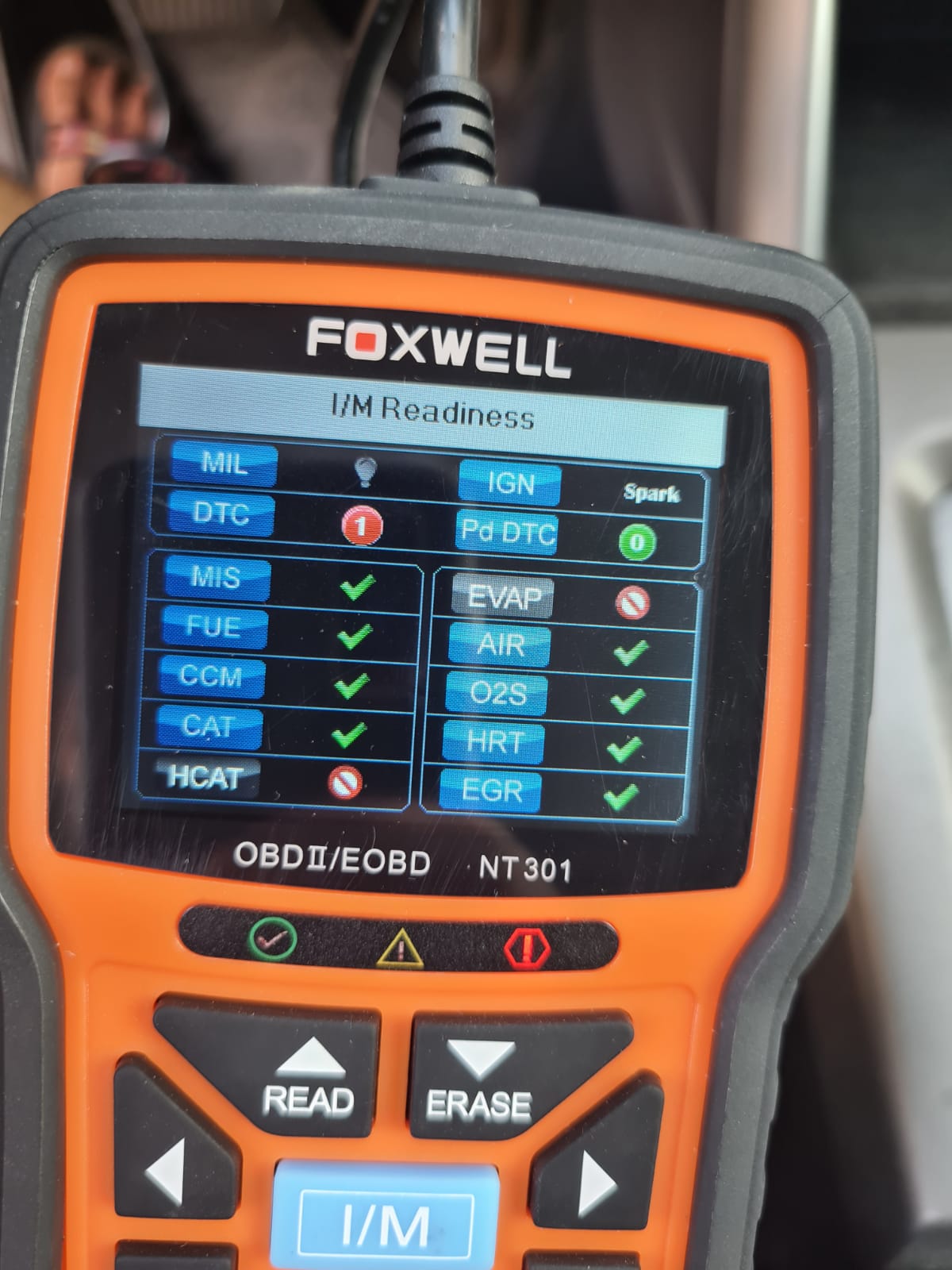

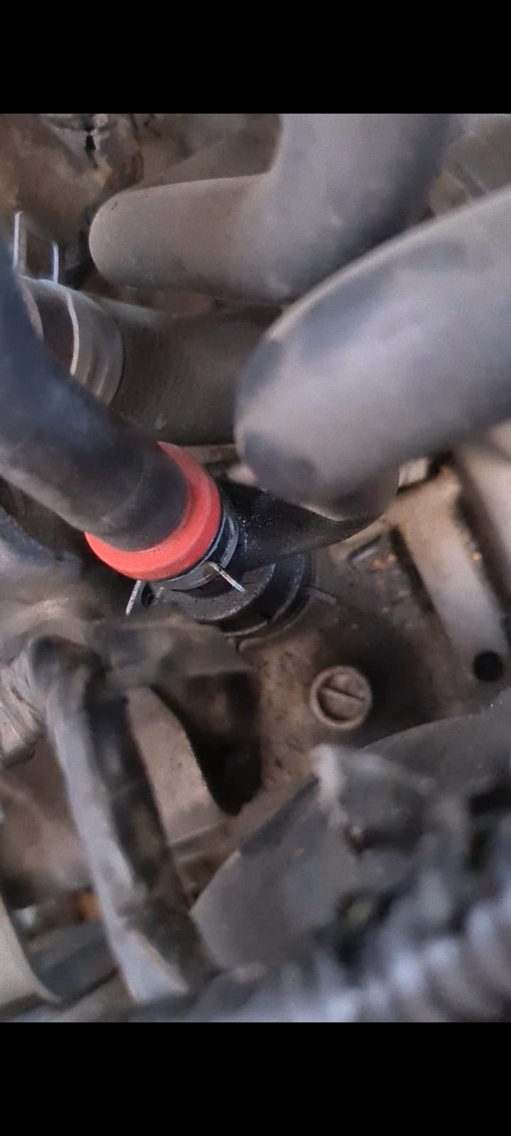

    - ( , )- , P0171 (System too lean bank 1) , .

     : pcv valve 2010
    pcv , , .

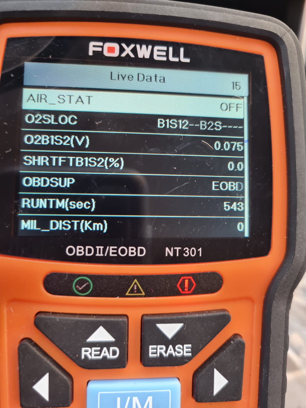

    1. ?
    2.-DATA STREAM

    -pcv .
    3 . .

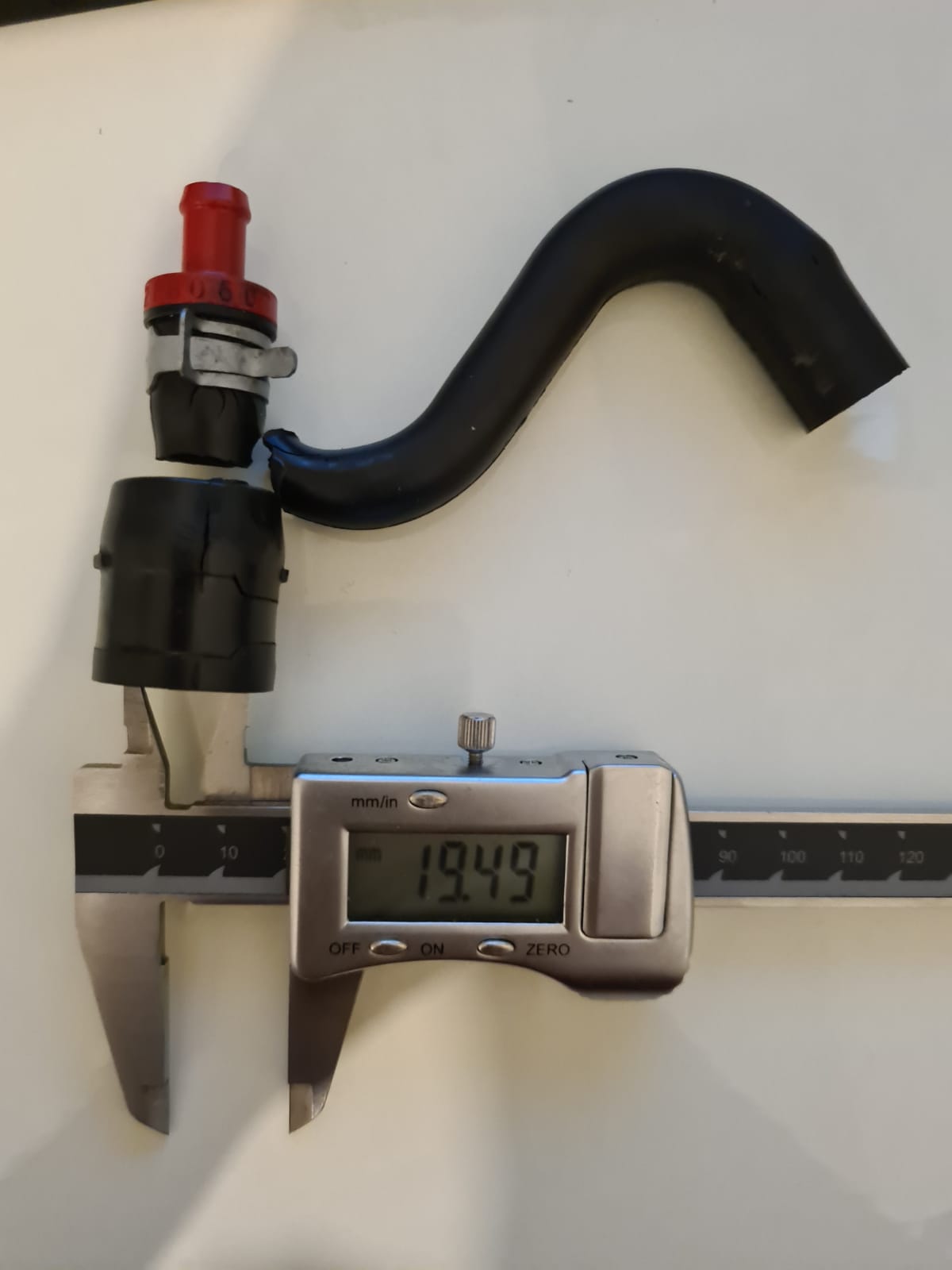

    PCV, , ... 2 - , ? , ... ?

    2.-DATA STREAM
    , , ? SHGBLGS? 00650-1011?

    [QUOTE=opt;956181] PCV, , ... 2 - , ? , ... ?
