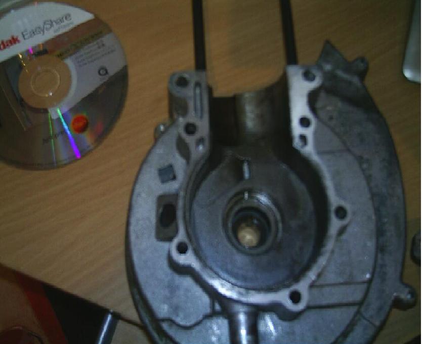

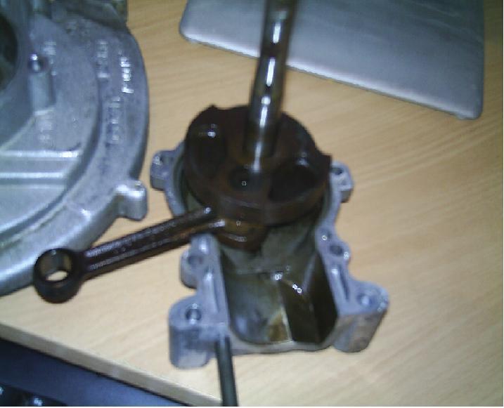

    δϊξεπεϊ ωμ ξιχεν δΰθξιν.
ID:	2358   Click image for larger version.

    δΰθν δεΰ 1 - 1 εηφι ξιμιξθψ

    ΰαμ μγςϊι πιϊο μμηευ πβιγ 2 ξιμιξθψ ωμ ηεξψ βξιω μβεγμ δψφει.
    δωΰμδ διΰ δΰν δϊηωαε αζδ αϊλπεο δξπες εμλο ωξε 1 εηφι λγι μδβις μ0.5 μξωμ.

    Kd,
    I'm sorry to be the bad news bear
    But.....before you invest another minute into that motor, get the crank/rod/bearing assy checked out
    I seen many that had rust on them, and non of them were usable
    when water gets in the crankcase 99% of the time the rod bearing is toast
    and so is the crank.

    ΰπι ιεγς.
    ζδ αβμμ θςεϊ θτωιϊ ωμι - δωΰψϊι ΰϊ δξπες τϊεη ιεϊψ ξιγι ζξο αμι δβπδ.
    ΰαμ ζδ αργψ τϊηπε ΰϊ δλμ εδξιραιν ηγωιν αλμ δξχεξεϊ.
    ωθηι δξβς μΰ δημιγε αβμμ ωων ςεγ διδ θιτδ ωξο.
    ξδ ωΰϊδ ψεΰδ ζδ ρϊν ηιφεπι.
