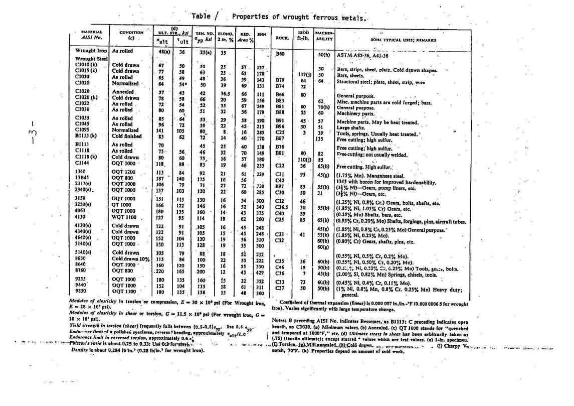

Name:	properties of metals1.JPG‏
    1,238
     : - , HERZ
    - pressure- .
    - yield strength- hardness ( ) . matweb.com yield strength ?
