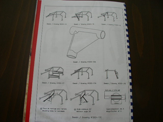

  4. #44
     's Avatar
    Dec 2005
    3,380
    kobiarava
    ? . , . fia (") . fia . .

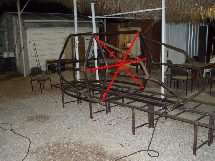

  14. #54
    kobiarava's Avatar
    May 2006
    3,053
    , -X , 100% . X , , ( V ) , FIA? , X , , ? , 1.25" ( 1.5" ), ?
  15. #55
     's Avatar
    Dec 2005
    3,380
    kobiarava
    , 1.25" ( 1.5" ), ?
  16. #56
    's Avatar
    34,821
    X , , . V , , . V , , .
    X, , * ... , , , X. , , . .
    X - . , . , , X .

  18. #58
    kobiarava's Avatar
    May 2006
    3,053
    (...) , V 30 ", , . () -X , , . ( ) : ) - , -48" -42"? ) X , , ?
  19. #59
    's Avatar
    34,821
    283 FIA,
    45X2.5 50X2.0 " . 38X2.5 40X2.0 .
    X , ?

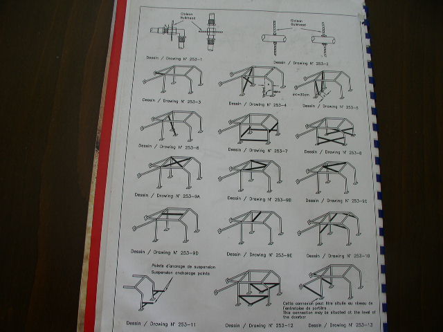

  20. #60
    kobiarava's Avatar
    May 2006
    3,053
    283 FIA,
    X , ?
    , X, .
    -X, , " : , ,
