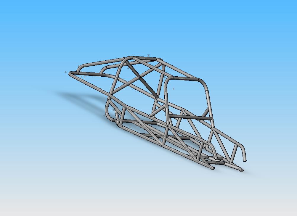

    CAD .
    1. 40 48 ", ? .
    2. "X" ?
    3. A ? , , , , .
    4. , (...) ( ( )), ? . .
    5. 26 40 48 " ?
Name:	iso2 (1000 x 800).jpg‏
ID:	4172   Click image for larger version.
Name:	iso (1000 x 800).jpg‏
ID:	4173   Click image for larger version.
Name:	not iso (1000 x 800).jpg‏
ID:	4174   Click image for larger version.
Name:	side (1000 x 800).jpg‏

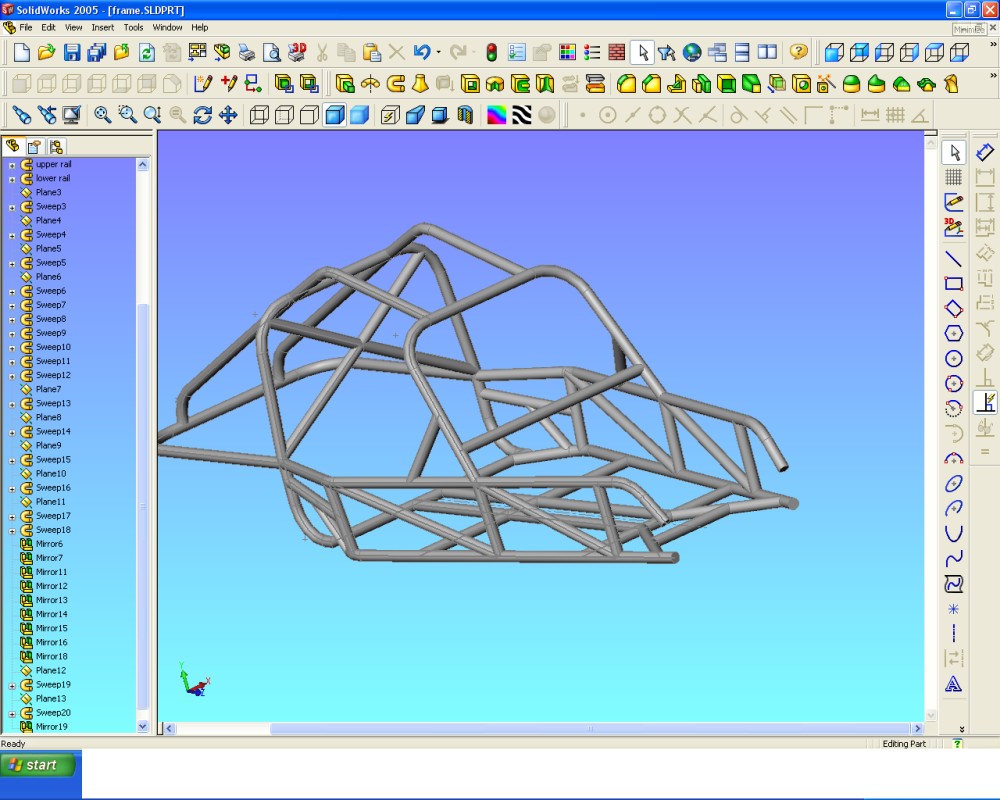

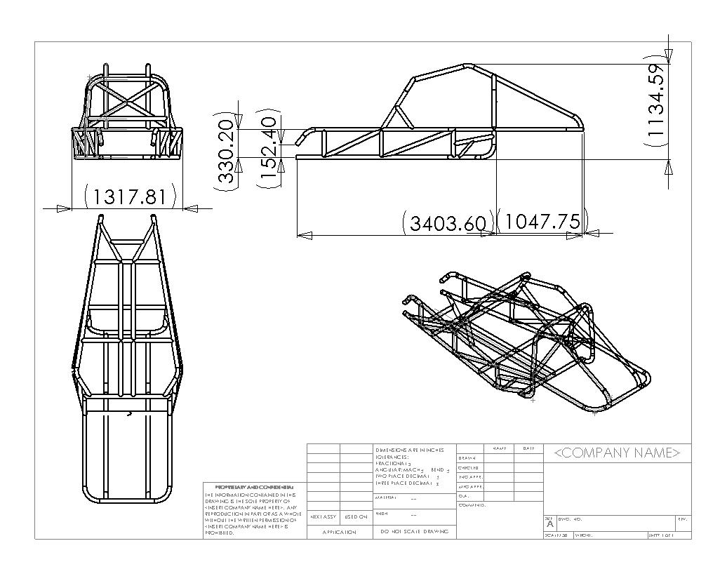

    options v -Parentheses , . drawings, .

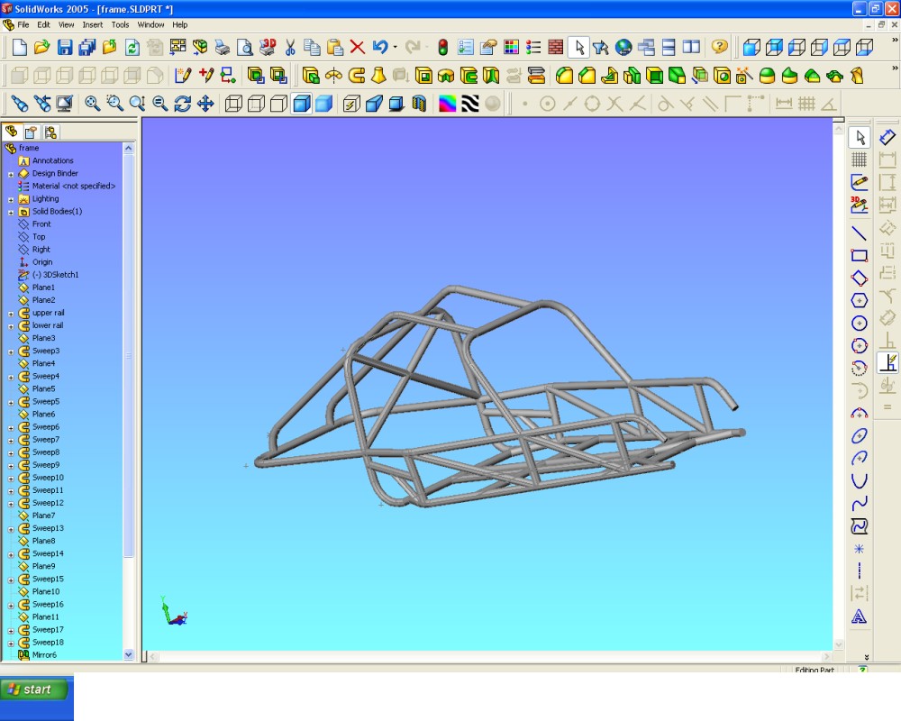

    X - . - .
    - . VW , , , , . ' , . A - , , .
