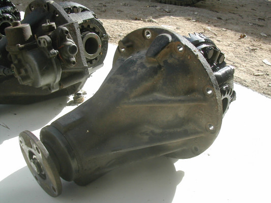

    8 44
    37 ....
    3 .
    84, , .
    110 "
    33 ( , ?)
    5.29 (4cyl
    4.7 ( )
    Aussie .
