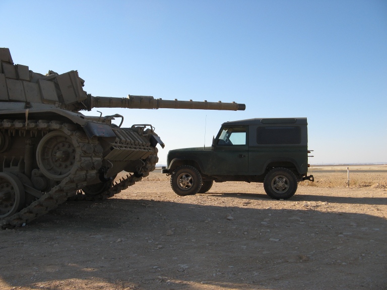

δρϊγψϊ ςν δθρθ?
110TD5
Festina lente
δθρθ ςαψ αμι ωεν αςιιδ![]()
