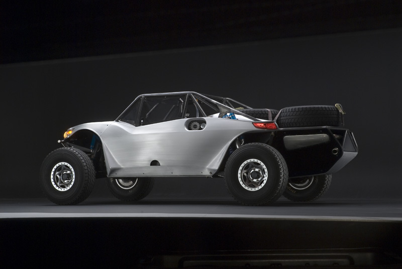

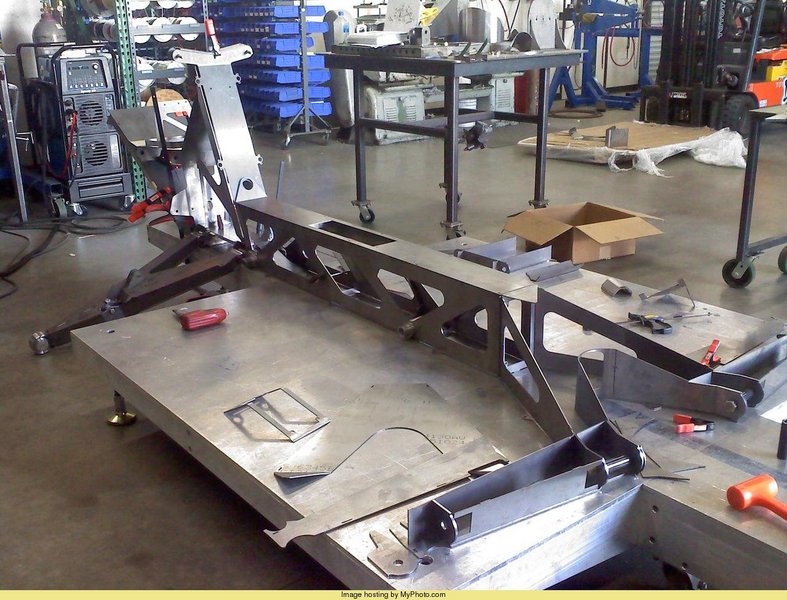

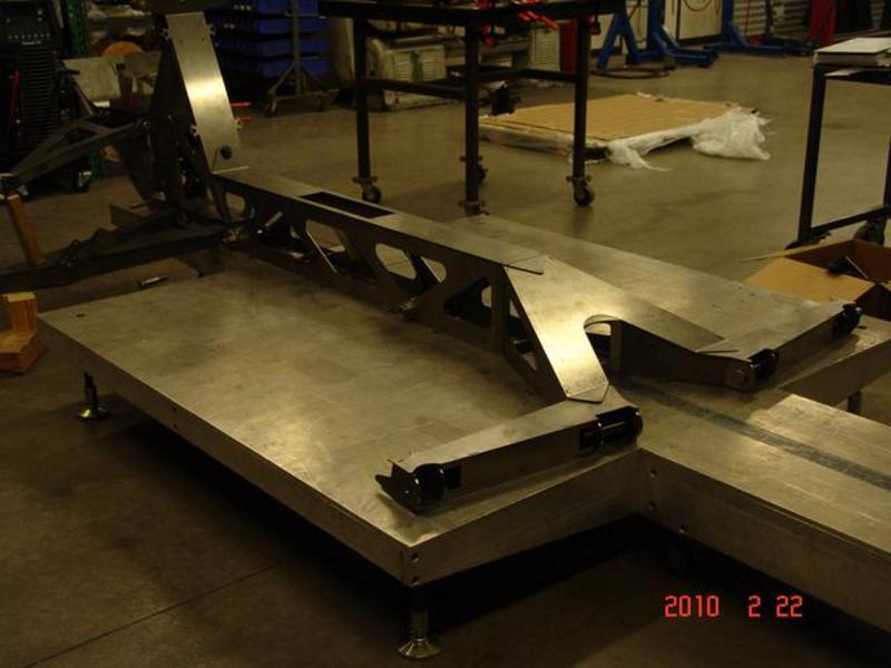

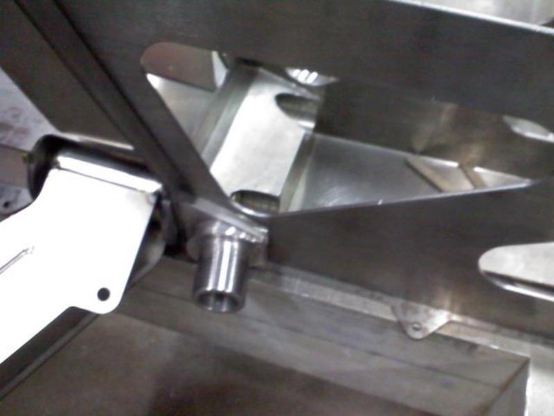

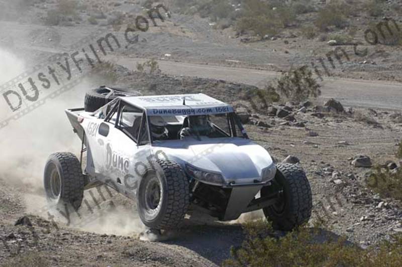

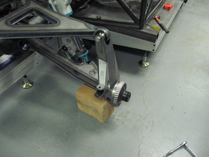

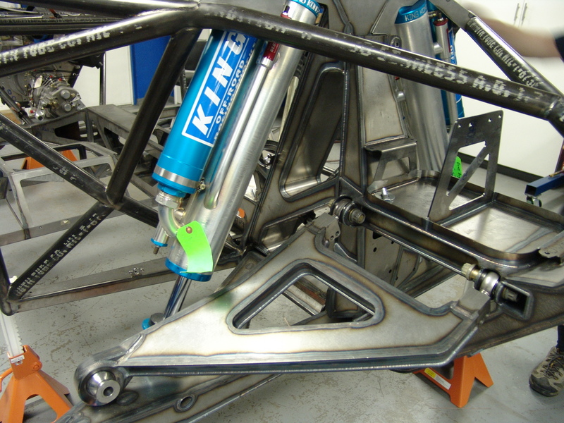

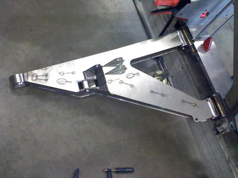

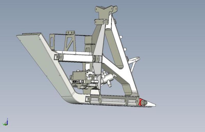

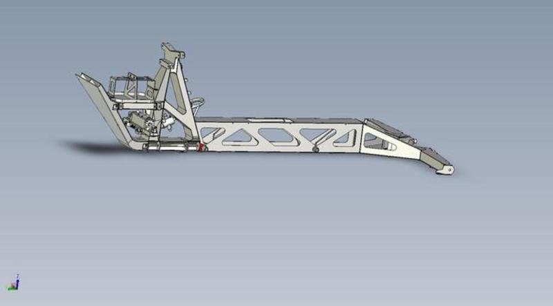

    This platform was designed for those that would like to build their own
    offroad car the way they want and give the owner of this platform many more choices than ever by allowing them to create their own chassis looks and configure everything the way they want.
    This platform also provides endless possibilities and can be used for 2 seat 3 seat 4 seat or even a single seater , Designed for full on race or you can choose to you can create your own playcar prerunner or even a full on trophy truck.
    Here are just a few specs on the platform.. 128" wheelbase 92" track. 28" front travel, 24" rear travel. 4130 plate construction fully Tig welded and Designed to run 37" (or even taller) tire.
    For those that just need some serious suspension we also offer just the front and or rear arms and spindles or the entire front clip.
    This platform has also been featured as a masterpiece of metal in dirtsports as has been extensively tested under the most brutal of conditions.
    Dunebuggy.com Special limited Pricing.
    Platform Package Completely Tig Welded (Spine Only) only 14,900
    Complete Suspension Packages Front Uppers/Lowers/Rear Trailing Arms and Spindles Fully Welded 7,500
    Complete Spine and Arm Package with all sleeves bushings aircraft bolts ready to go Only 23,000

    εμξι ωμΰ πτμ δΰριξεο,,,λμ ϊϊ δωμγδ δϊηϊεο λμεξψ ηεθ δωγψδ ωμ δψλα εδζψεςεϊ ςωει λεμε ξτηιν. ΰιο ΰτιμε φιπεψ ΰηγ.
    αψιψϊ ξηγμ ϊβεαδ μδεγςδ: ΰεξπεϊ ααπιιϊ αΰβι...ΰϊν ιλεμιν μδζξιο ...
    מה היתרון של השיטה הזו?
    דני
    γπι δδιϊψεο ωμ ωιθδ ζε ζδ ωδιδ "self gig " αωιμγδ λξε ωδιδ ξετιςδ τδ ηρψιν φιπεψεϊ μηζχ ΰεϊδ ξλεηεϊ τιϊεμ ελιτεσ ΰαμ λΰωψ δψλα διδ ςν λμεα δαθιηεϊ ζδ ιτϊεψ ΰϊ δςιπιο .

    πψΰδ μι ωιω λΰο ξρτψ ιϊψεπεϊ:
    1. ηεζχ ξαπι
    2. ξωχμ πξεκ ιεϊψ ξξρακ φιπεψεϊ
    3. γιεχ, αβμμ ωδτμΰθεϊ ηϊελεϊ αμιιζψ.

    ηπο γπι εςιγε ωμεν
    χεγν λμ δαΰβι δζΰϊ ξεφςϊ μαπιιδ εξλιψδ λωπϊιιν.
    γαψ περσ δξωχμ μΰ αδλψη ιεϊψ πξεκ ξξρακ φιπεψεϊ λι δεΰ μΰ ξαθμ ΰεϊε μημεθιο.
    διιϊψεο δβγεμ αιεϊψ ωμε λξε ωλϊα ςιγε ζδ ωΰιο φεψκ αβ'ιβ ααπιιδ ωμ δψλα δλμ ωχς ϊχς.
    ΰφμπε απιιϊ ψλαιν ξξεβπιν λμ δχετρΰ ωμ δψλα διΰ λκ. λμ ημχ ωφψικ μψϊκ ξβις ςν ηεψιν αφγ ΰηγ ετιπιν αφγ δωπι. δξρβψ μΰ ιλεμ μθςεϊ ξηαψ ΰϊ δηχιν εξψϊκ.
    ςν ΰπι μΰ θεςδ βν πξψεγ πχθ αωιθδ ζε ααπιιϊ δζψεςεϊ εημχιν περτιν αψλα ωμε.

    απιιδ αημχιν ωθεηιν, ηϊελιν αμιιζψ, ςν ξβψςεϊ εαμιθεϊ, ιςιμδ ξΰγ, ξχαμιν ξαπιν ξγειχιν εχμιν ξΰγ μδψλαδ. δδωχςδ δβγεμδ διΰ αϊλπεο ωφψικ μδιεϊ ξγεχγχ, ΰαμ δαπιιδ ςφξδ ξδιψδ εαςιχψ ξγειχϊ ξΰγ. αθπγψ ωμ ρψθιπδ λμ δαριρ ωμ δωμγδ, λμ πχεγεϊ δςιβεο ωμ δξϊμιν, λξε βν ζψεςεϊ δξϊμδ, παπε αφεψδ γεξδ ξΰγ μξδ ωΰϊδ ψεΰδ λΰο.
    δςπιιο δωπι ωαεμθ λΰο δεΰ δωιξεω αωγψδ ξψλζιϊ ξριαιϊ, εζδ γεεχΰ ξωδε ωΰπι τηεϊ ξϊηαψ ΰμιε. ζδ ξρδ βγεμδ αφιψ ξψλζ δψλα, ωμΰ ϊεψξϊ δψαδ μχωιηεϊ μτιϊεμ ωμε αιηρ μξωχμ ωμδ. γψκ πλεπδ ιεϊψ μγςϊι διΰ μαπεϊ λζδ γαψ μΰ αφεψδ T ΰμΰ αφεψϊ ξωεμω, λξεαο ωθεη/πξεκ δψαδ ιεϊψ λι ΰπωιν φψιλιν μωαϊ ςμιε, λωΰϊ δχωιηεϊ ξρτχϊ ωμγϊ δφιπεψεϊ δηιφεπιϊ. *
