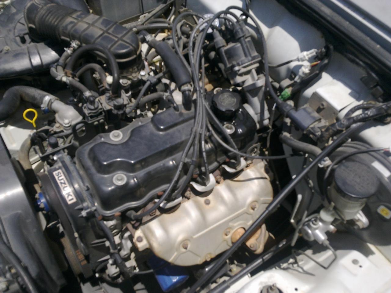

    дрд ъоерд одйен ббечш щм дорет ещм држймд догебшъ.
ID:	25178   Click image for larger version.
ID:	25179   Click image for larger version.
