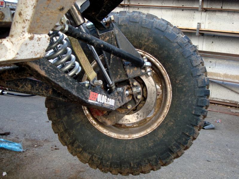

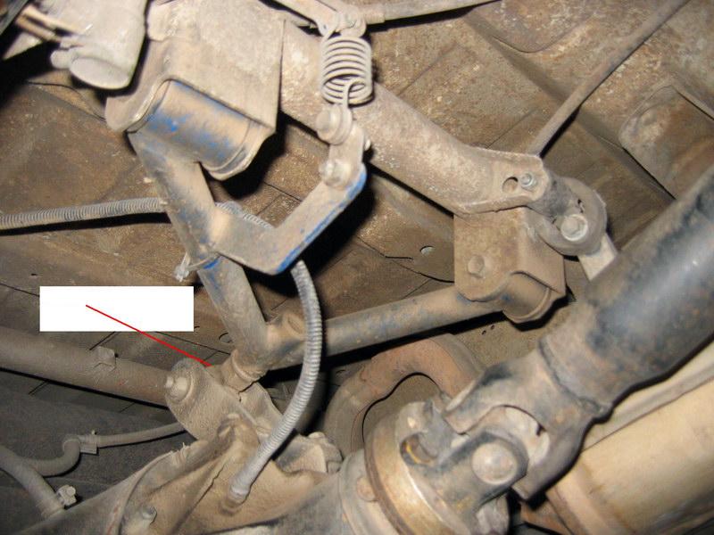

    a ( ).
    , " ", 10 ' ( ) .

    , (IKO) "", , a , , .
    POS12 12 '. ( ) .
    JMX12 JMX14 FK .

    raanan
    a ( ).
    , " ", 10 ' ( ) .
    Misalignment angle. High Misalignment ( ). , .
