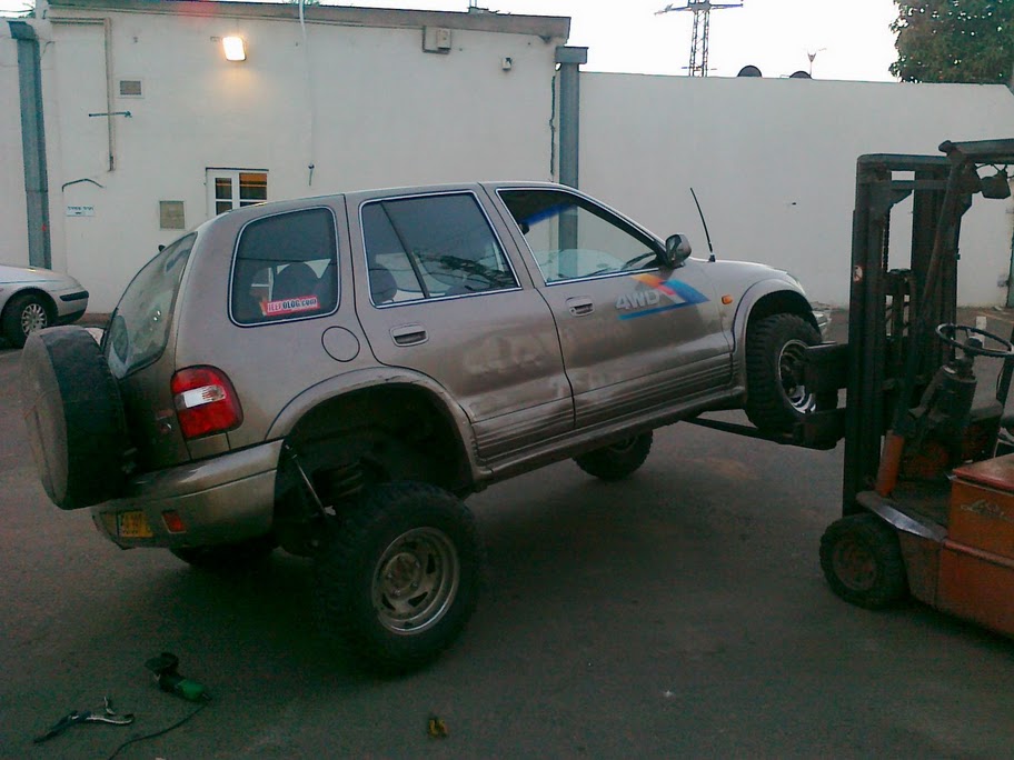

    - 4.5 ( 3 ). , . ( 4.5 - - ):
    https://picasaweb.google.com/1085460...57455152485410
    ( - ? Z$% - , ).

    hadtomer
    ( - ? Z$% - , ).
    - , ( 90), , . : ( - ).

    HELLO MR HADAR
    - The problem
    is rear spring fatigue created by torque during acceleration. As an offroader accelerates, it torques to one side on the rear axle. Over a short period of time this causes one rear coil to fatigue prematurely and loose lift height. As you increase lift height this problem becomes more severe; the higher the vehicle the greater torque angle
    we will be more than happy to re inspect the springs
    SHANE
