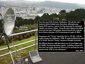

    δβιψρΰεϊ διεϊψ "ωεεϊ" - φμηϊ:
    http://www.trevormarshall.com/biquad.htm
    http://www.usbwifi.orconhosting.net.nz/
    http://urbanwireless.info/antennas/d...th-biquad-feed
    ΰϊ δξηωα ωιςαεγ απχεγδ δξψεηχϊ , ΰϊδ ξβγιψ αφεψδ ωιελμ μωϊσ ΰϊ δψωϊ βν μξηωαιν ΰηψιν.
