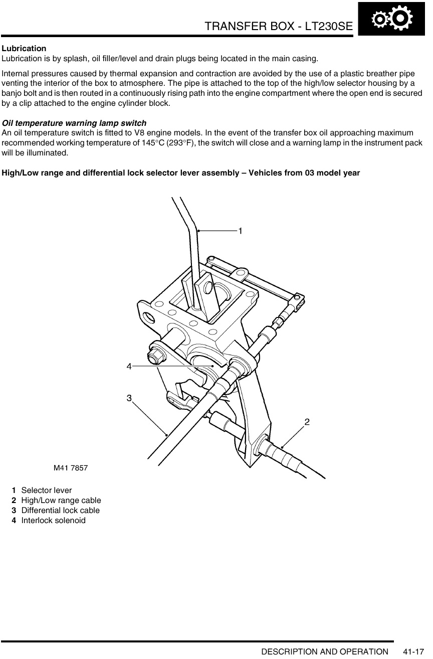

    ϊχψΰ τδ:
    DISCOVERY GEARBOX INTERLOCK ASSEMBLY
    Discovery vehicles with automatic transmissions are equipped with a transfer gearbox interlock
    solenoid which prevents the driver from moving the transfer gearbox lever from high to low or
    from low to high unless the automatic transmission is in neutral. In any event, gear changes
    should always be made at less than 5 mph (7 kph).
    Shown below is the transfer gearbox interlock and related components used on Discoverys with
    automatic transmissions through 2003 model year.
    Beginning with the 2004 model year, the range select interlock solenoid is moved to the shift
    lever housing.

    αργψ, αιγιεϊ ωπξλψεϊ αΰψδ"α αωπϊεο 2003 εξςμδ ιω ρμεπεΰιγ αιγιϊ.
    αιγιϊ ωμι τιψχϊι ΰεϊε δηεφδ ξδιγιϊ μτπι δδψλαδ αψλα.
    ζδ ςαγ ξφειιο ςγ μΰ ξζξο, HIGH/LOW + DIFF LOCK αωπι δθεεηιν.
    μΰ δφμηϊι μζδεϊ αςιδ ξλπιϊ αλαμ μξψεϊ WD40 ωωξϊι αλξεϊ θεαδ.
