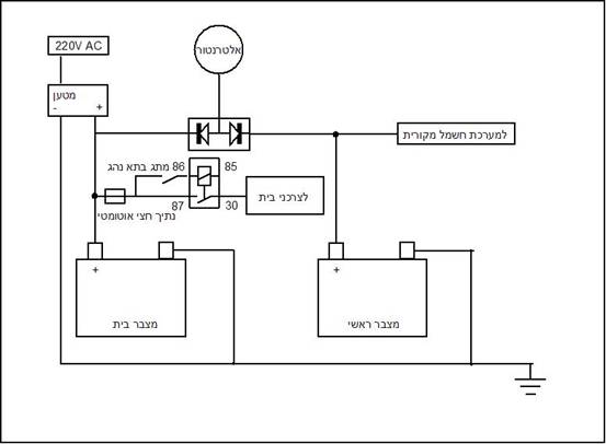

  3. #23
     's Avatar
    Dec 2008
    304

  4. #24
     's Avatar
    Dec 2008
    304
  5. #25
     's Avatar
    Dec 2008
    304
  6. #26
     's Avatar
    Dec 2008
    304
    85
  7. #27
     's Avatar
    Dec 2008
    304
    0.5V
    -220V
    220
  8. #28

  9. #29
     's Avatar
    Dec 2008
    304
    MOSFET

  10. #30
     's Avatar
    Dec 2008
    304
    boaz avrahami
    battery brain
