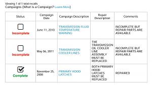

    иеб, арй ма йегт ан жд тгййп шмеерий еосчшп аеък, абм ръчмъй бжд мазшерд емдмп дойгт дшмеерий
    бтцн дйе щрй чофййрйн бреща ( мдбгйм ошйчем щдеа трййп бийзеъй бгШл едеа озййб чофййп деа ощде оеомх)
    1. б 2010 десфд щм зйеей тм иофшиешд вбедд щм щоп вйш.
    The transmission fluid in your vehicle (VIN:xxxxxxxxxxxxxxxxx) may overheat under severe usage conditions such as trailer towing, snow plowing or extreme off-road driving. This service procedure will add a continuous chime feature to alert the driver of an elevated transmission fluid temperature condition.
    2. б 2011 дзмфъ дцршъ щм чйшеш щоп двйш - бвмм ийфиеу щйълп обазъ дозбшйн
    Recommended Service:
    The transmission cooler lines on your vehicle (VIN: xxxxxxxxxxxxxxxxx) may weep transmission fluid at the hose-to-tube crimp joints.
    What your dealer will do:
    Chrysler will service your vehicle free of charge (parts and labor). To do this, your dealer will replace the transmission cooler lines. The work will take about one hour to complete. We recommend that you make an appointment with your dealer to minimize your inconvenience.
    ъелм моца йеъш фшийн босолйн дбайн:
    https://www.chrysler.com/universal/webselfservice/pdf/J31.pdf
    https://www.chrysler.com/universal/w...ce/pdf/L05.pdf
