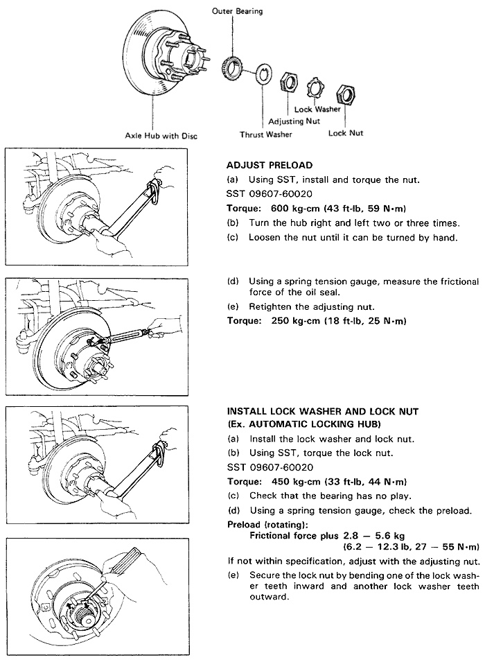

    ξφΰϊι ΰϊ ζδ αηιτεω χφψ ατεψεν ΰερθψμι
    1. Pull the parking brake lever all the way out (or up) and count the number of clicks to the end of travel. On 2WD 1/2 ton vehicles should have 12-18 clicks; 1-ton, 2WD vehicles and all 4WD vehicles should have 11-17 clicks. On 1989-95 4Runner check for 13-19 clicks and 1996 4Runner 7-9 clicks. If the parking brake lever is not within these ranges, adjust it.
    2. Under the truck on 2WD models, there is an equalizer bar where the 2 cables come together. Tighten or loosen the adjusting nut until the lever travel is within the proper range. Check that the rear brakes are not dragging.
    3. Under the truck on 4WD models, tighten the bellcrank stopper screw until the play in the rear brake links becomes zero, then loosen the screw 1 turn. Tighten the locknut.
    4. Tighten one of the adjusting nuts on the intermediate lever while loosening the other one until the lever travel is correct. Tighten the adjusting nuts.
    5. After adjustment, check that the bellcrank stopper screw is touching the back of the brake backing plate.
    6.Recheck the parking brake travel.

    λο, ζδ ζδ, ϊεγδ.
    θεωι δραιψ μι αθμτεο, εςωιϊι ΰϊ ζδ αιηγ ςν δςεαγ.
