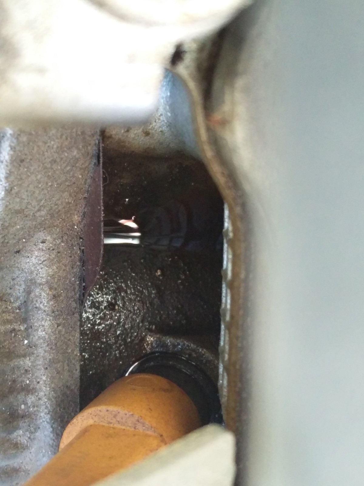

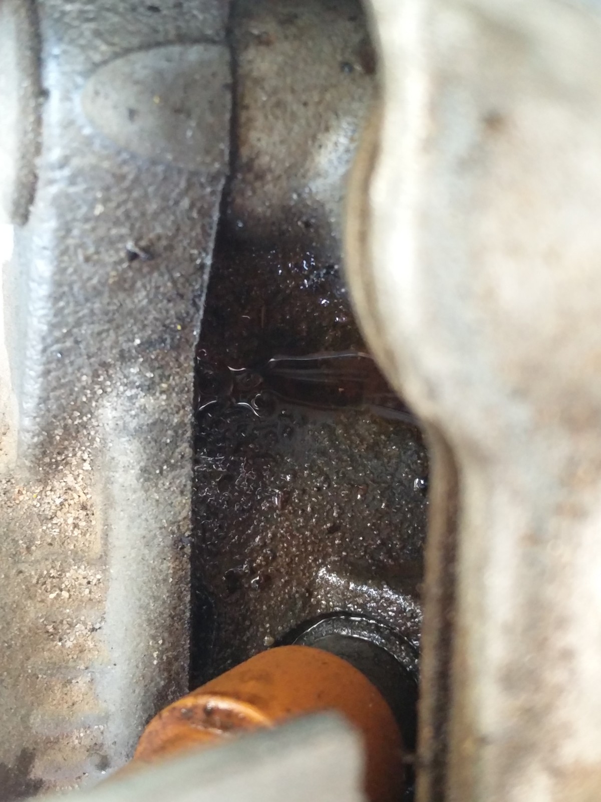

    φγ ωξΰμ ωμ δξπες, μΰ αψεψ μι ςγιιο ξΰιτδ δαψιλεϊ ωξο δχθπεϊ δΰμε,
    *ξδτχχιν δλϊεξιν δΰμε?

    ιω ξφα ωϊςμδ ϊξεπδ ςν τηεϊ ζεν? μΰ αψεψ ξδ ξφεμν..

    ζδ ξδ ωςπε μι ατεψεν ξηε"μ (Big Jimny):
    That will be the cam cover gasket: needs a new one, and carefully torquing the fastners. if you over tighten them to stop the leak, the cover distorts and leaks more.
    check that the black hosepipes leading to the top of the engine, and the grey valve by the dipstick are not blocked up
    i'd give a little squirt of gunk, and wash it off personally (actually, i wouldn't bother, any oil running down the engine will help sto[ the sump going rusty
    http://www.bigjimny.com/index.php/fo....wa49LZiM.dpuf
    id=59155#sthash.wa49LZiM.dpuf
    ξδ ΰεξψιν?
