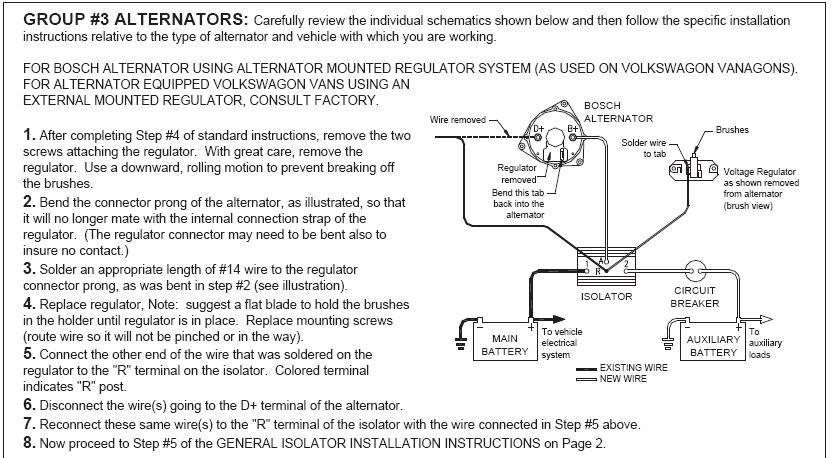

    ISOLATOR. . + , ( , ). ?
    - VW TYPE 2 1978 | - 2008
    asafk's Avatar
    35,297
    lior_b.s's Avatar
    Feb 2005
    1,286
    3 ..
    asafk's Avatar
    35,297
    3 - D+ D- DF , B+ /.
    D+ . ( + ' ).
    ( , ) R, D+ R ( D+ ) ?

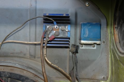

    asafk's Avatar
    35,297
    R ?
    , , R. - D+ , R, ?
