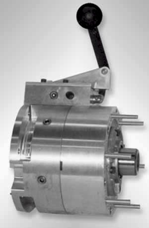

    . - Klune V. 2 , , 1:1. , . " " .
    -Klune V ; "" 1:4, $1,895.00, "" 1:2.7 $1,695.00. -Klune V , .
    '' -RubiCrawler Advance Adapters, , . -RubiCrawler 2009 ' JK ( ) . -RubiCrawler 1:2.72 $1,495.00 (" ).
    ' ' , -Klune V, JK. , ( ) , . . ? , ( ) , . " . , NP203:

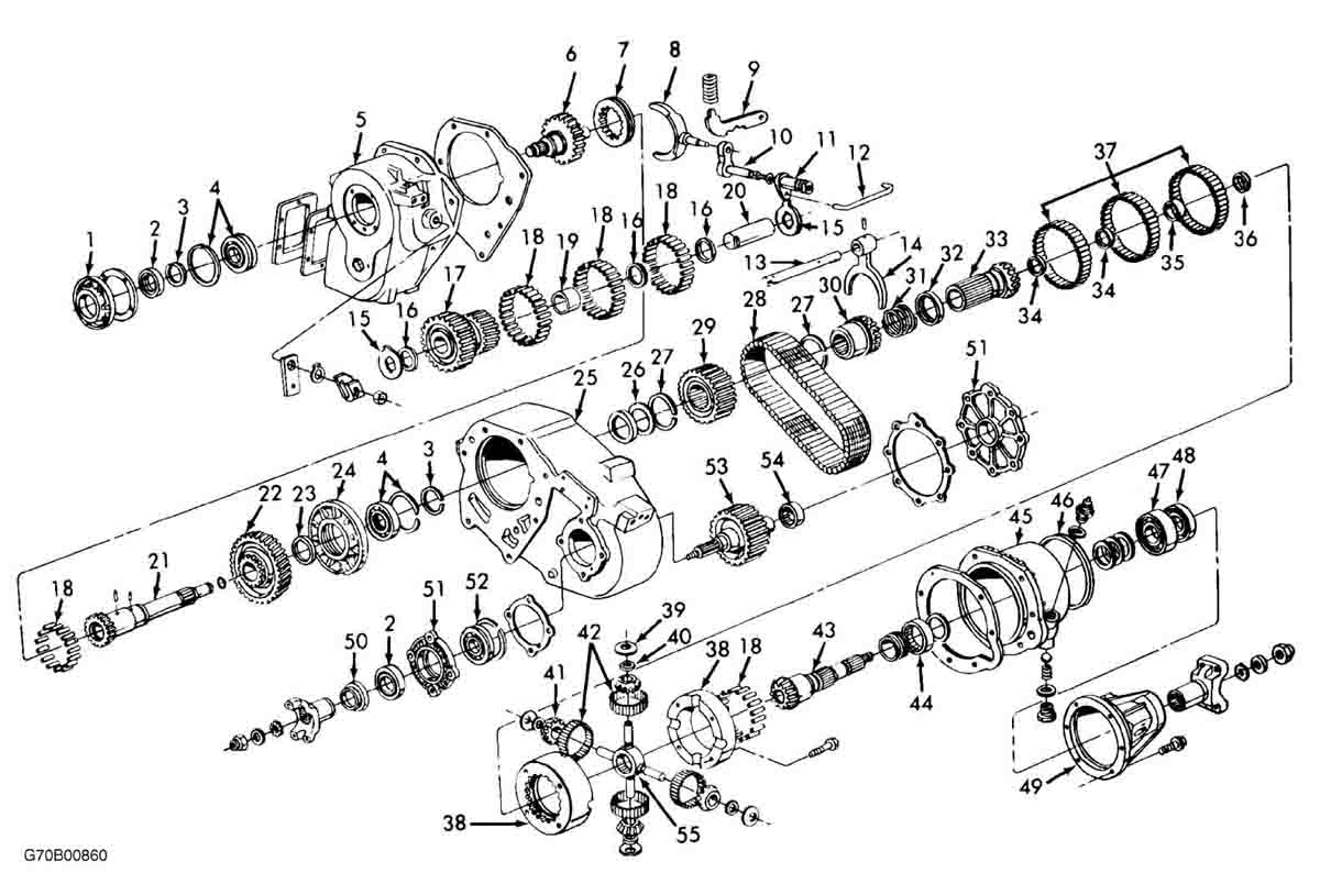

    -231 - 241 (...).
    NP231J ( J . J '. NP231C , D '). . , .
    . " " NP203 NP205. .

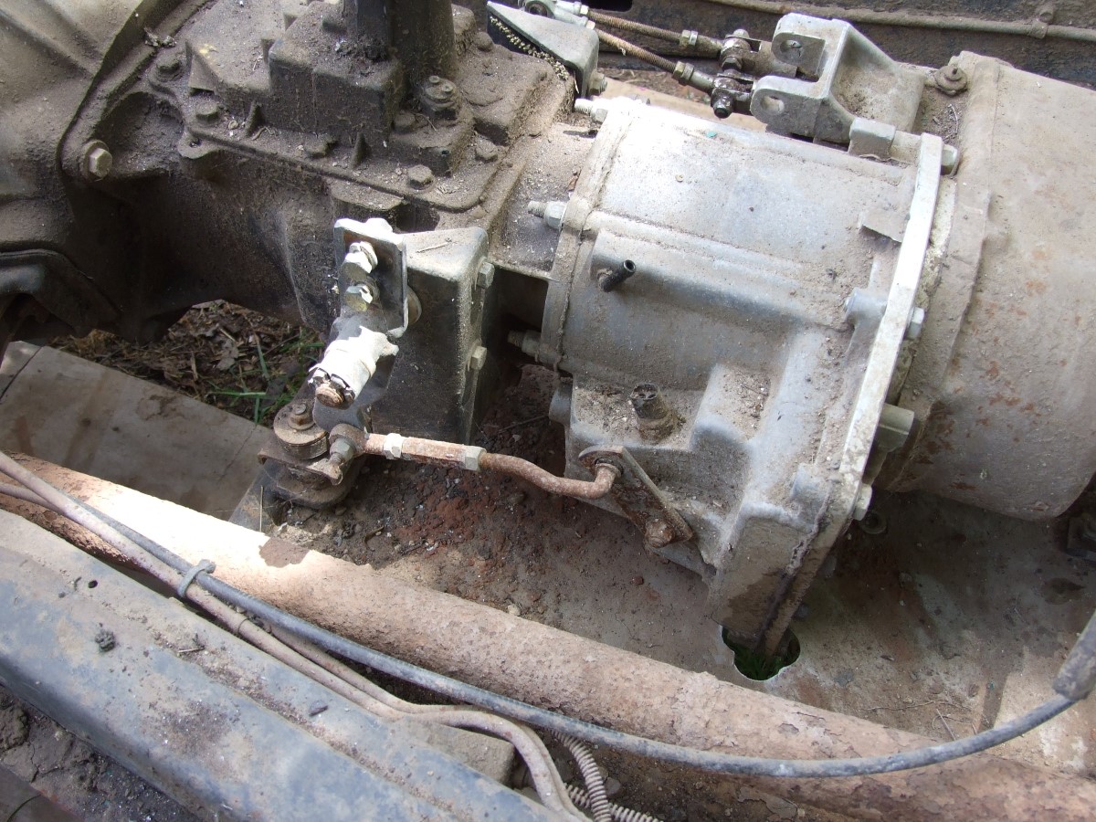

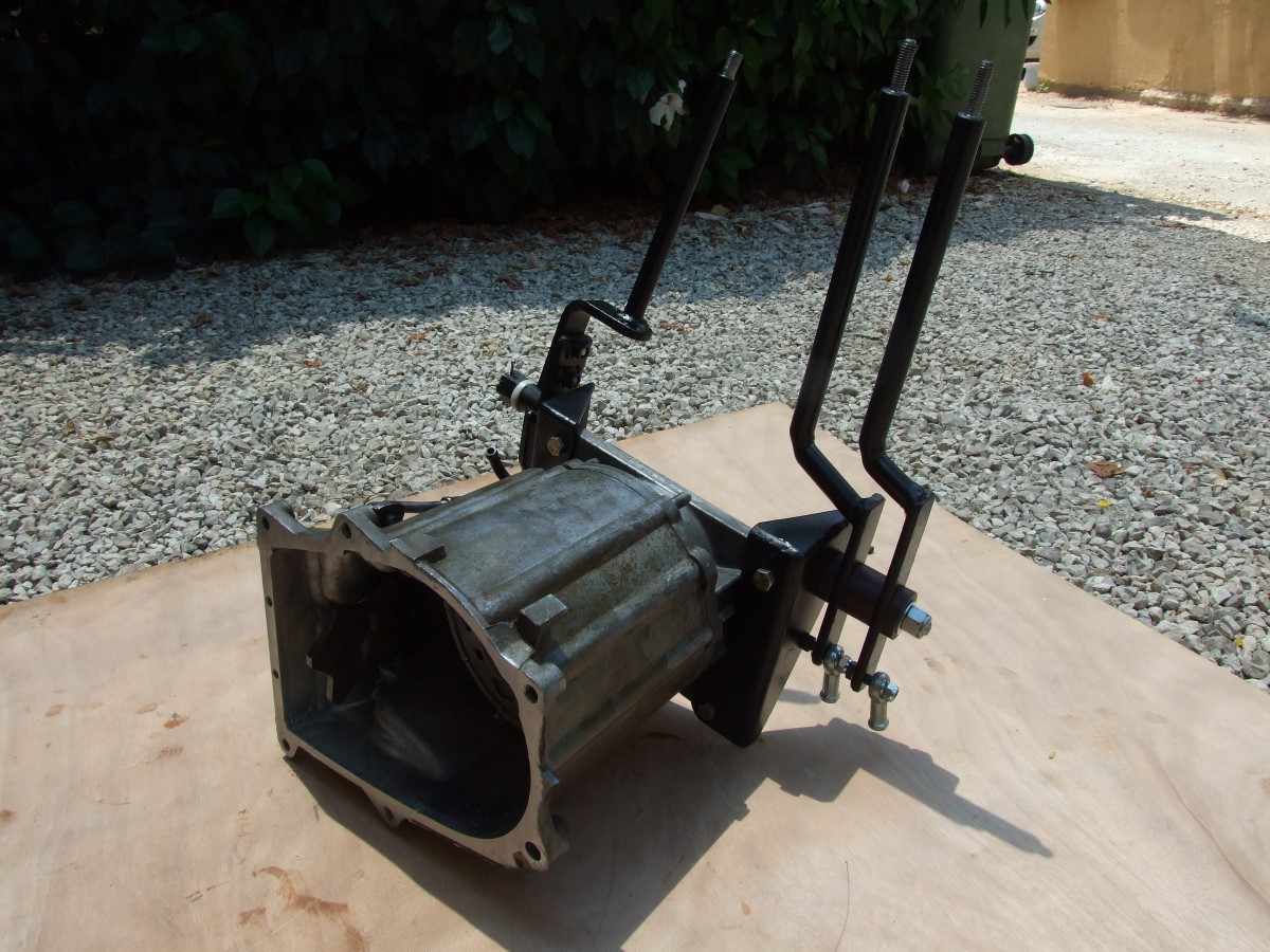

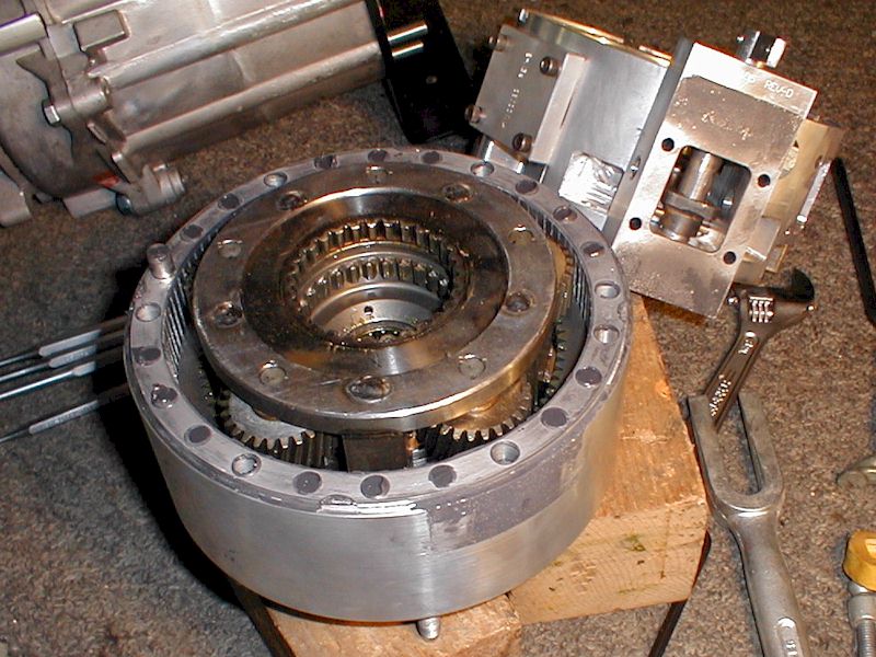

    , , \ , . , -CJ :

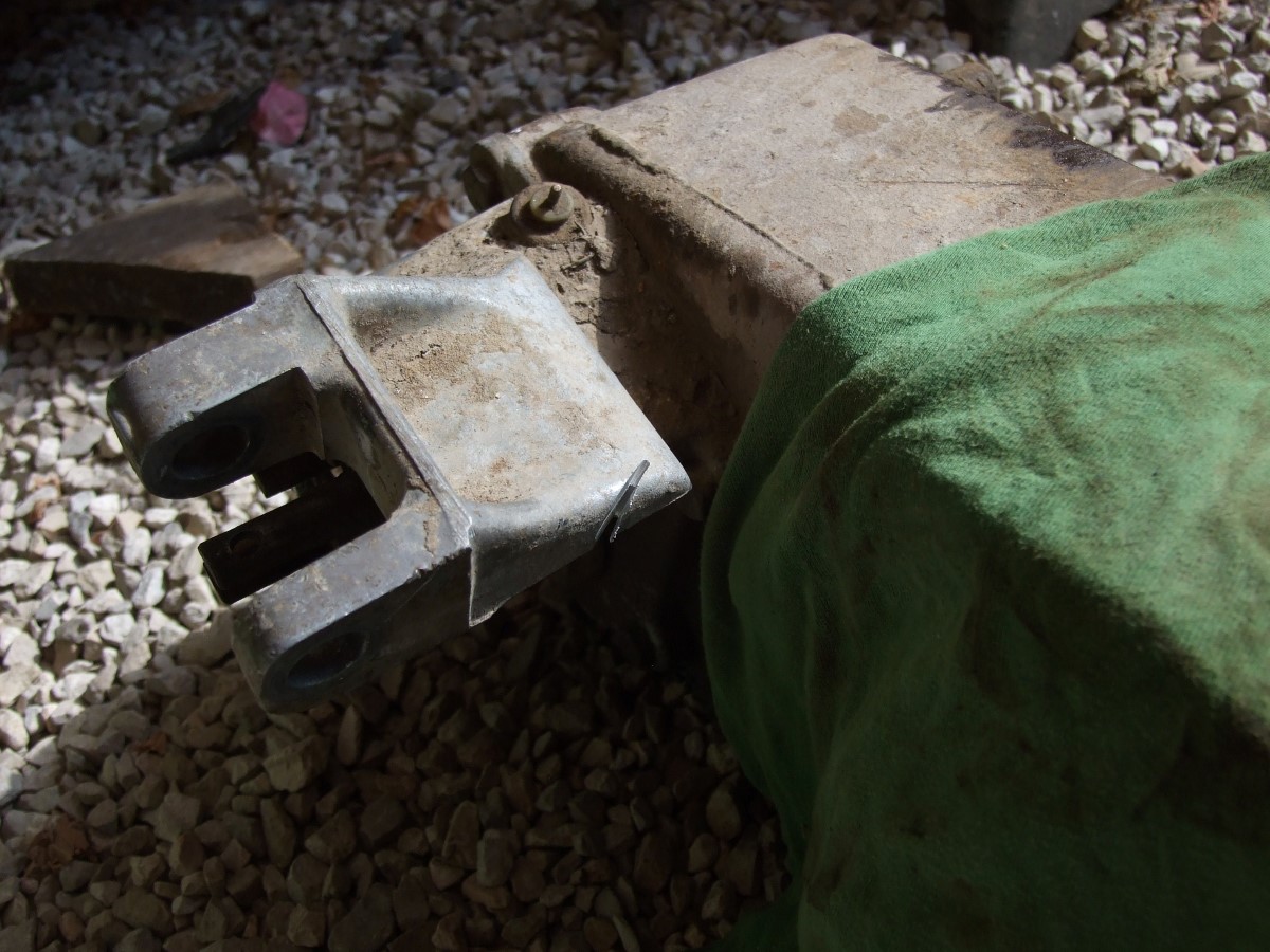

    ' CJ, "" , 258, T-176 , 300. T-176 23 , ( , ). 300 23 .
    ' YJ 242, AX-15 NP231J ( 241 ). -CJ AX-15 23 , . 231 23 .
    . ? , . 300 AX-15 , . 300 , Novak Conversions.
    Novak Conversions . .
    ' NP231J 300 .
    , , , , 23 , , , .

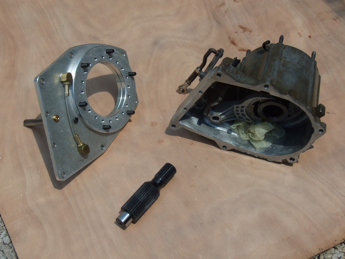

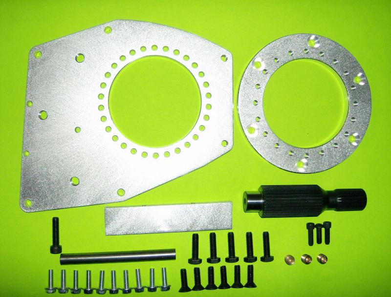

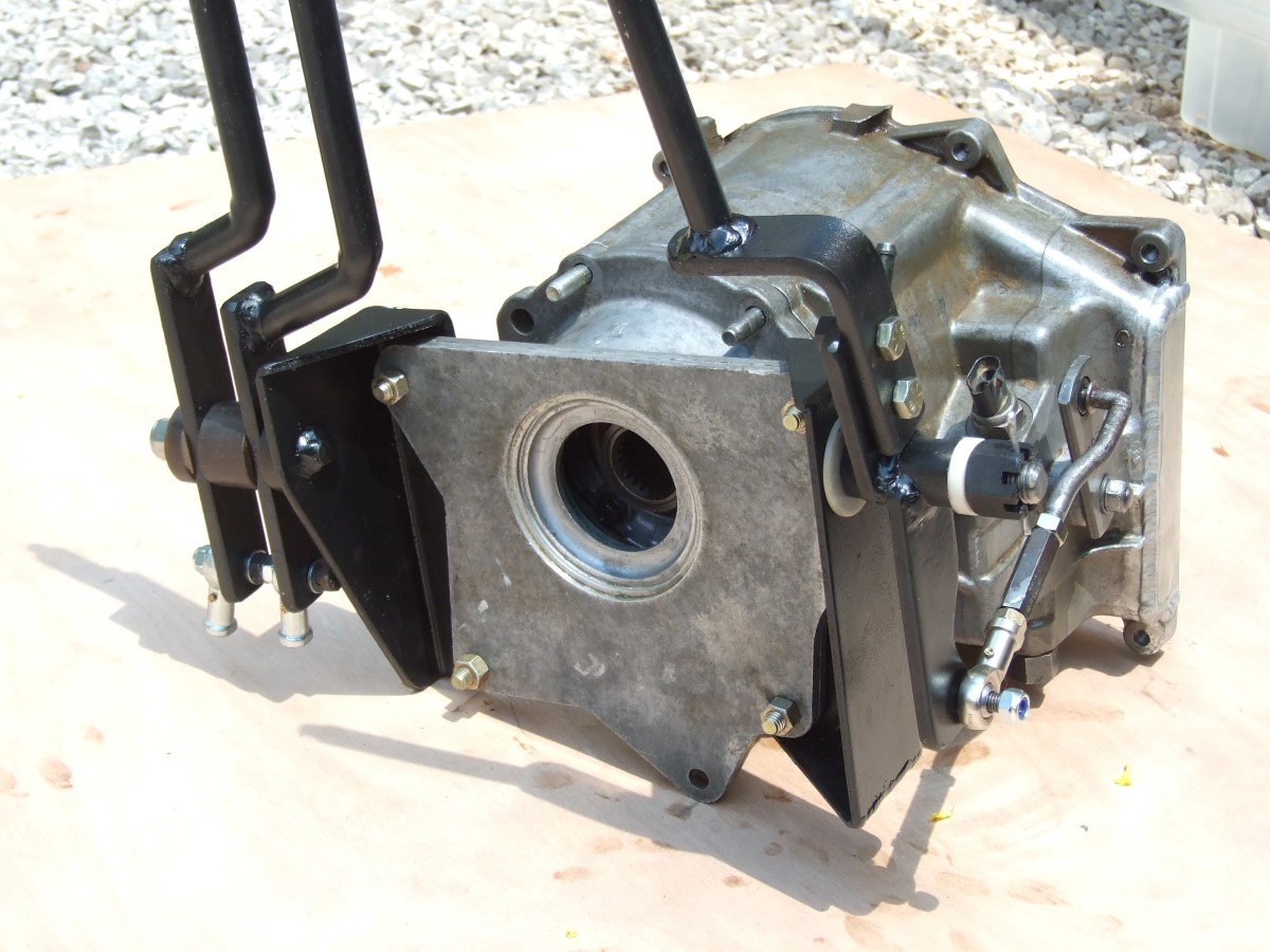

    -Ebay Box4Rocks, 500$, ". . , . "" 2007.
    ; NP231J , , .
    , , . , T-176 AX-15 , , 300 NP231J.

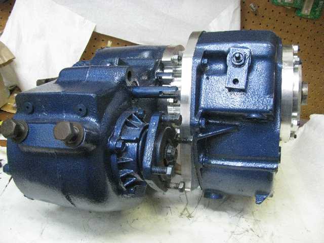

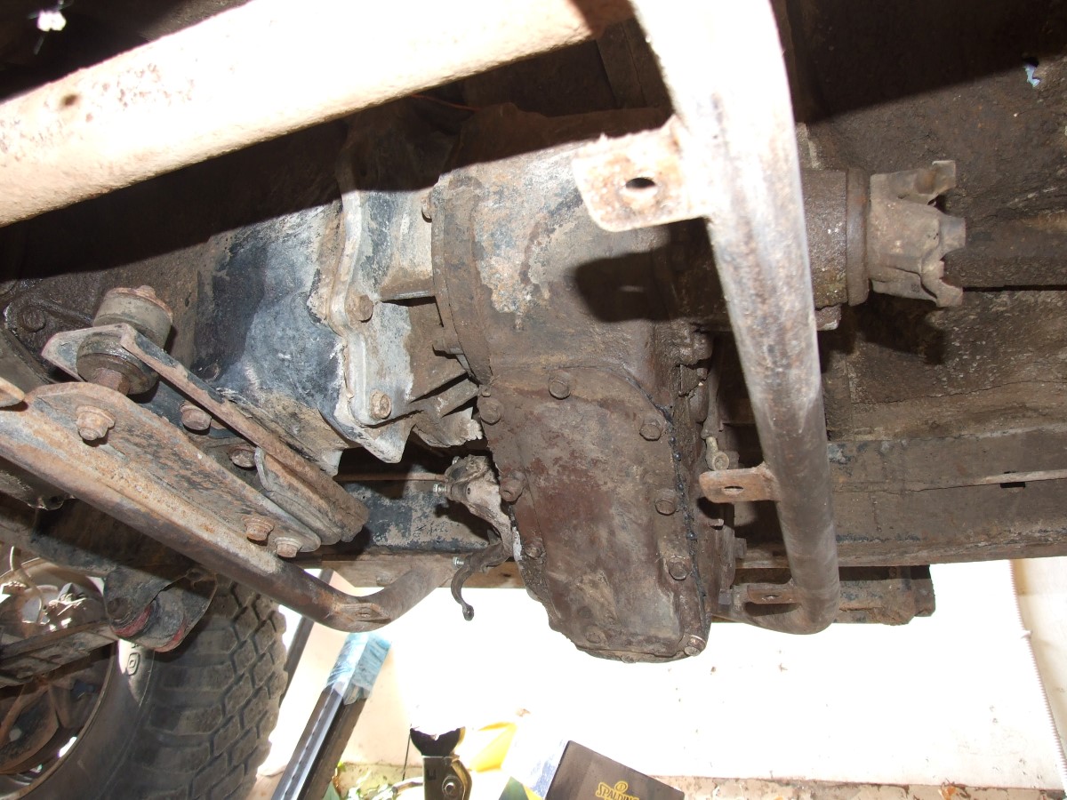

    200 ", -8". . , -200 " , 2 , . , , . .

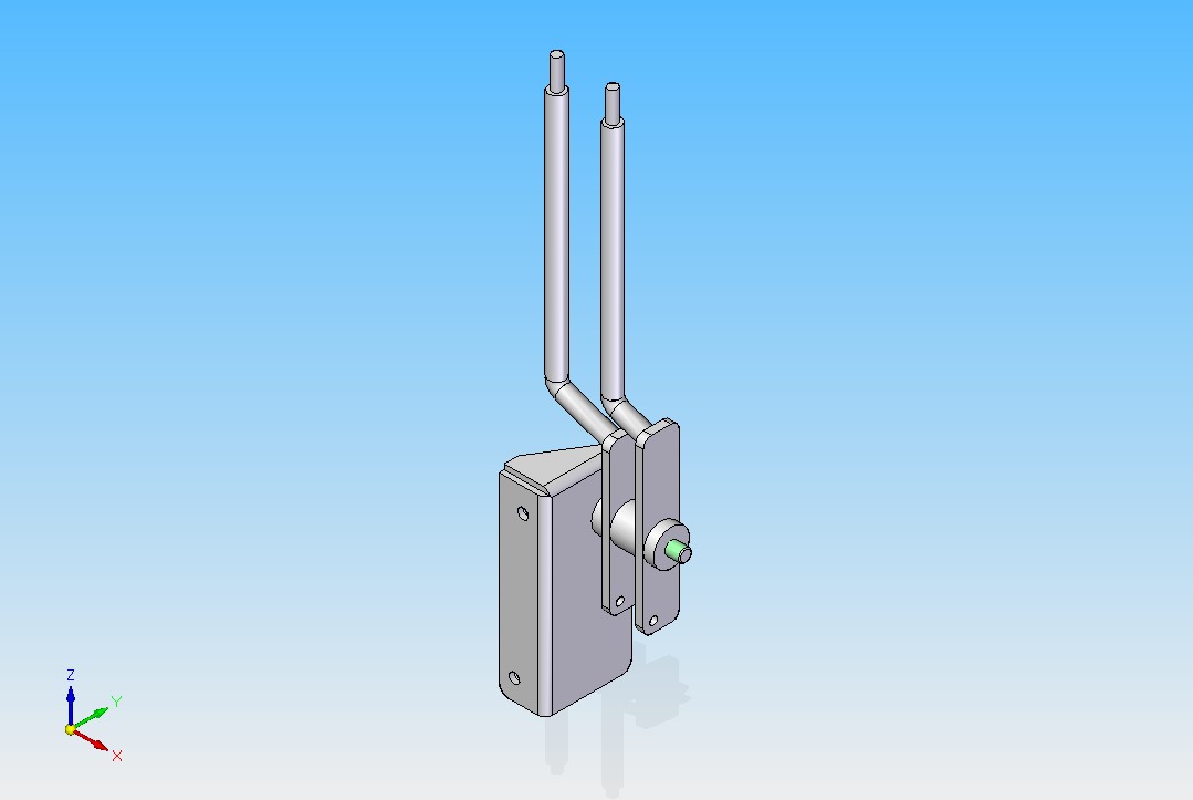

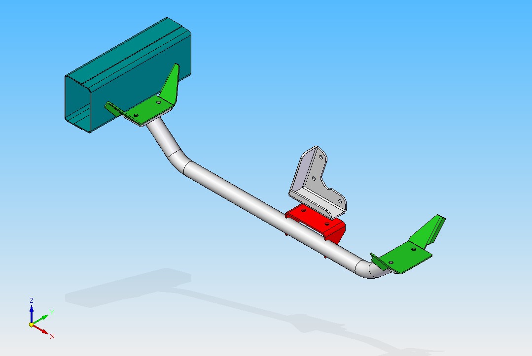

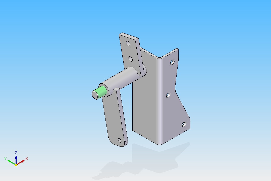

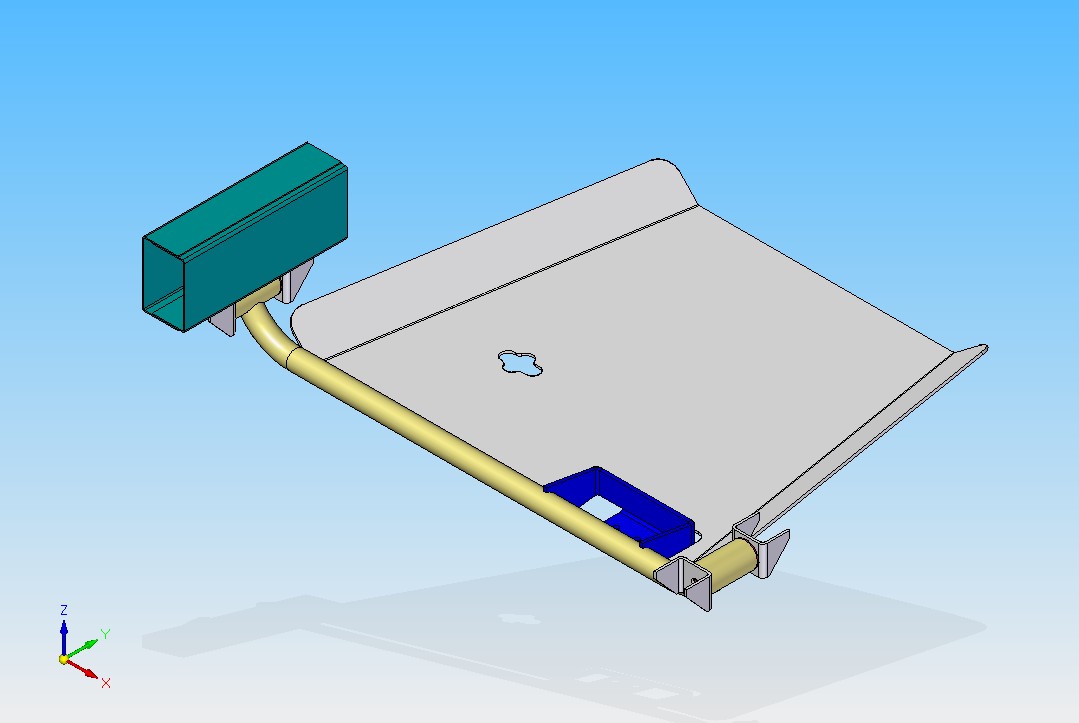

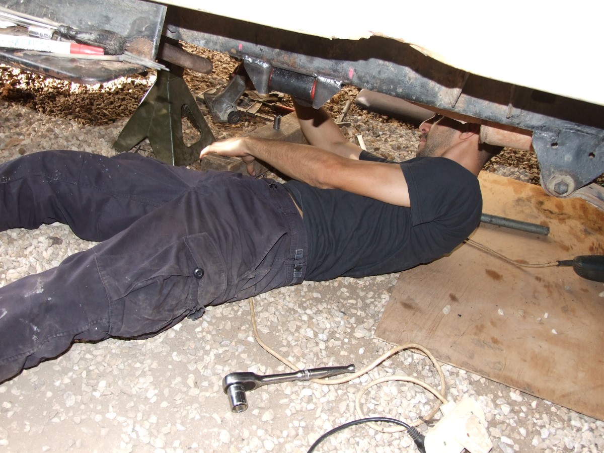

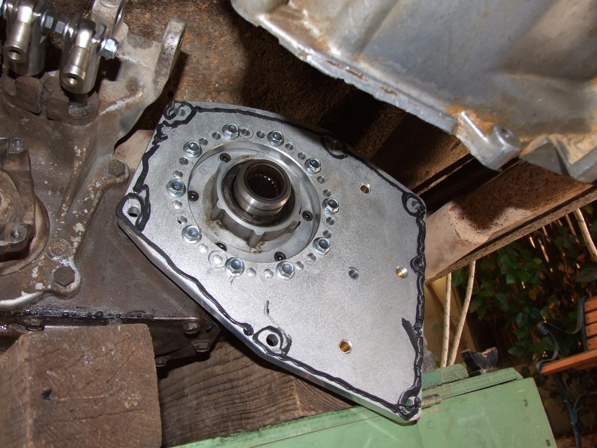

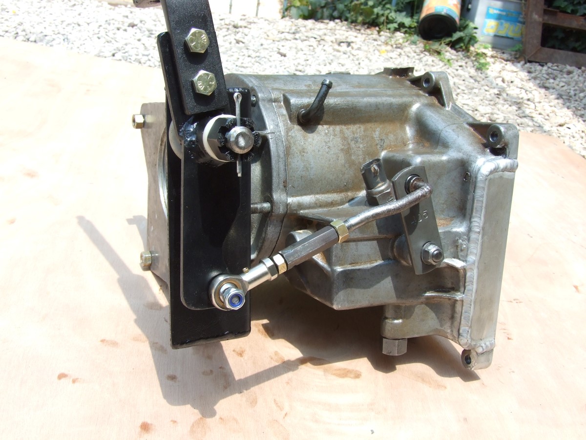

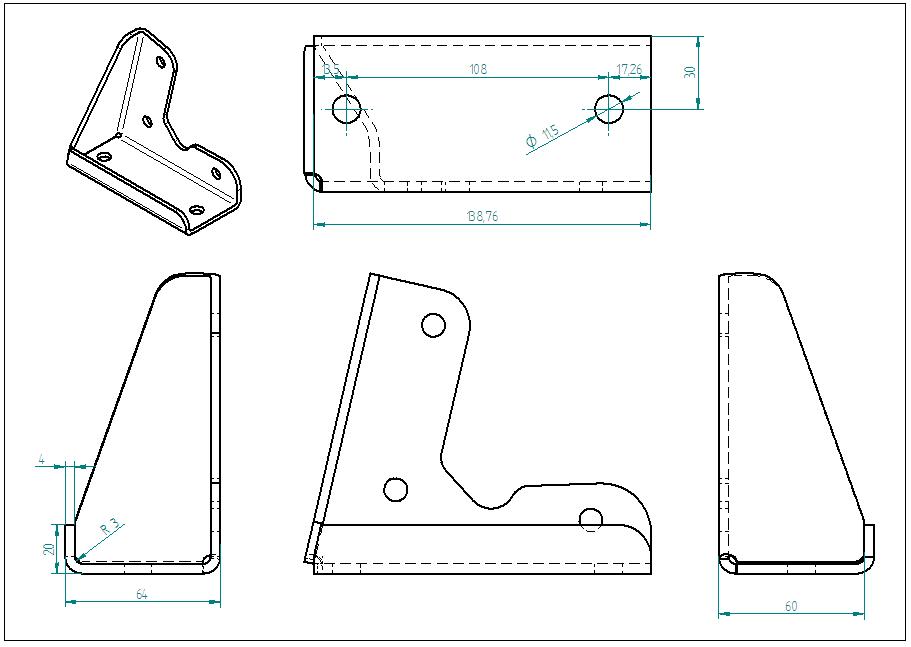

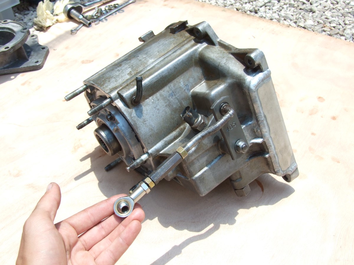

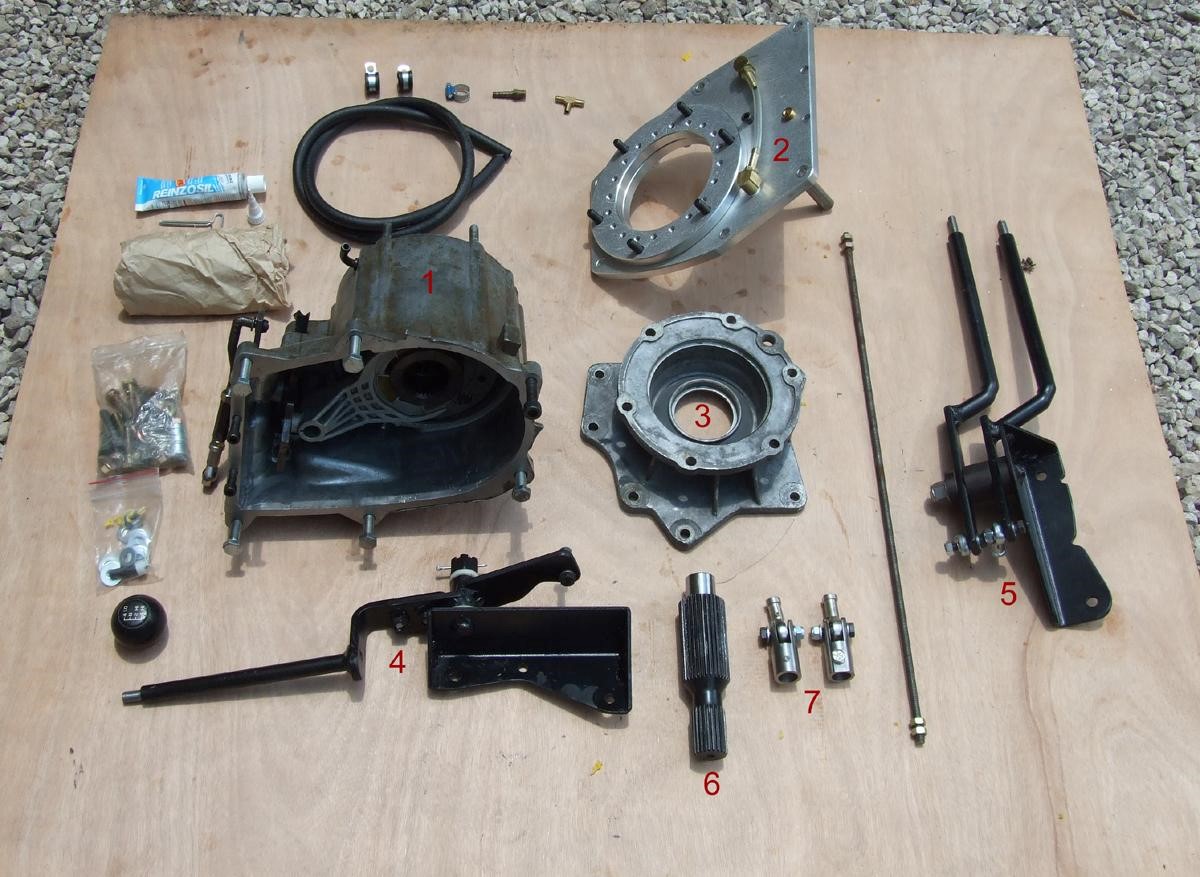

    CJ . " SolidEdge.

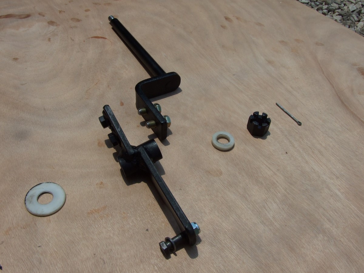

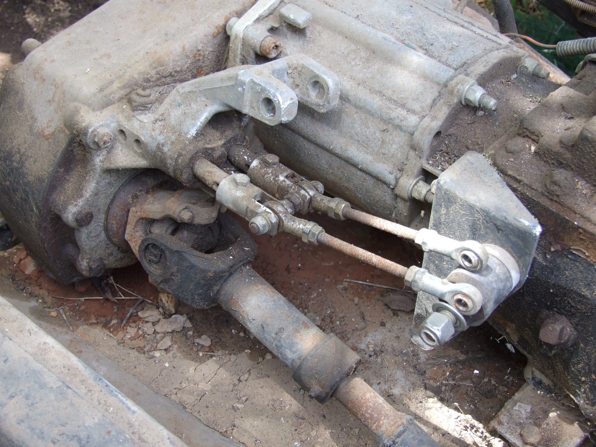

    8 " . :
    1. NP231J
    2. .
    3. T-176 to Dana300
    4. , .
    5. - 300 , .
    6. 300 .
    7. 300, .

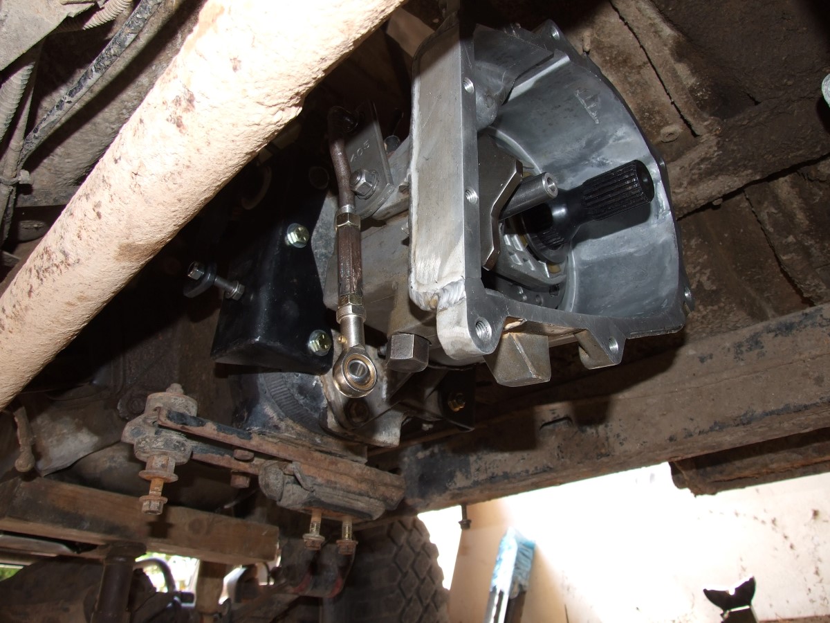

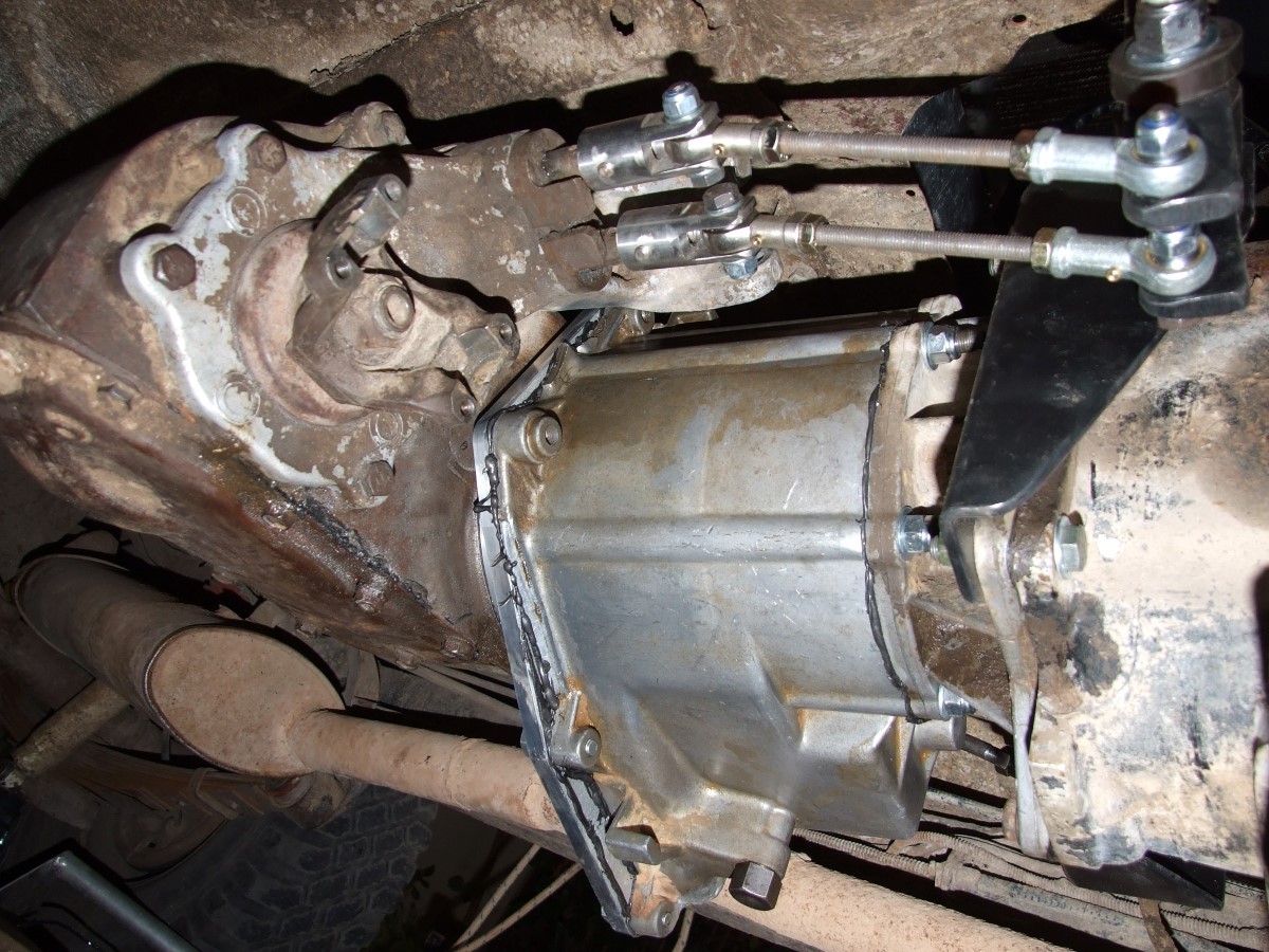

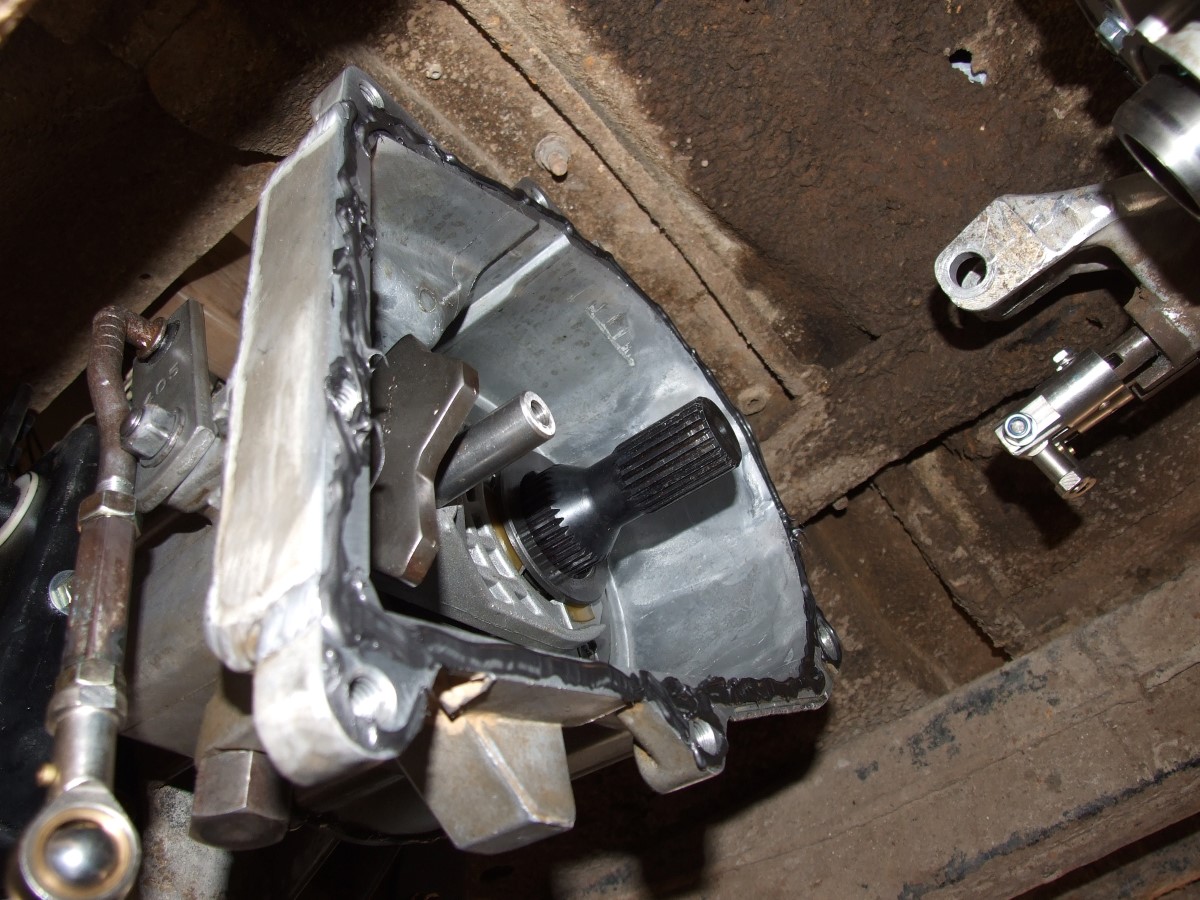

    , . ( ), ( ). , ( ) . , ; 700 ", , 700 " - 2/3 . .

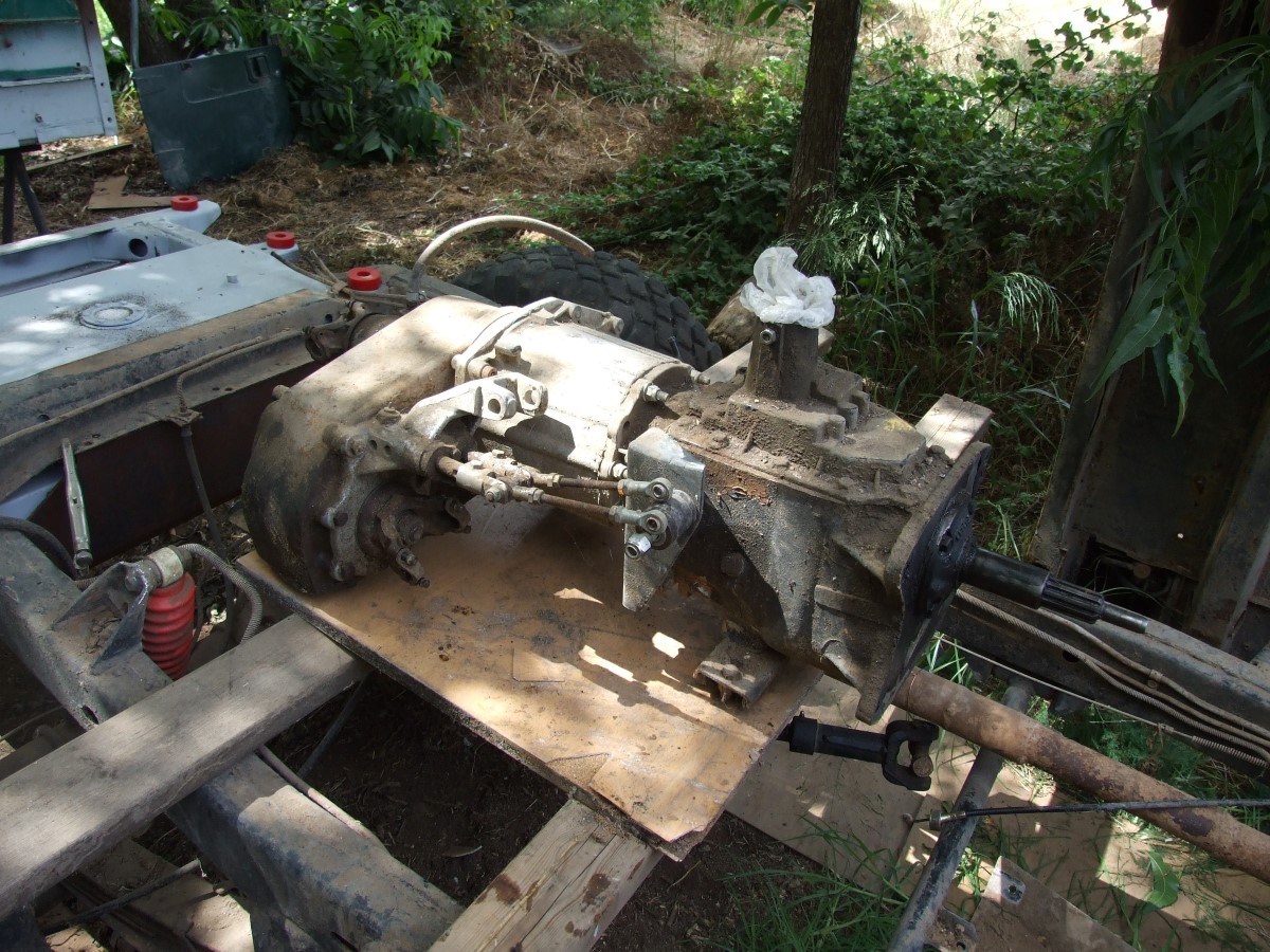

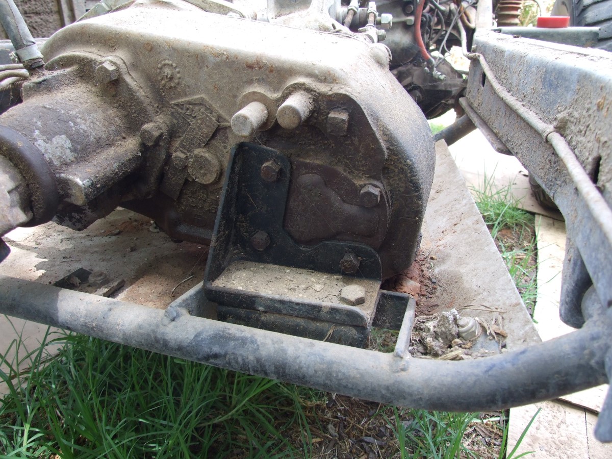

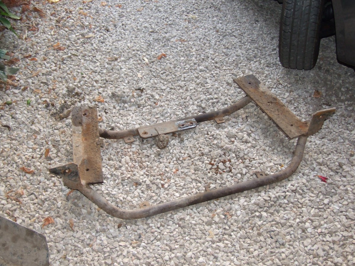

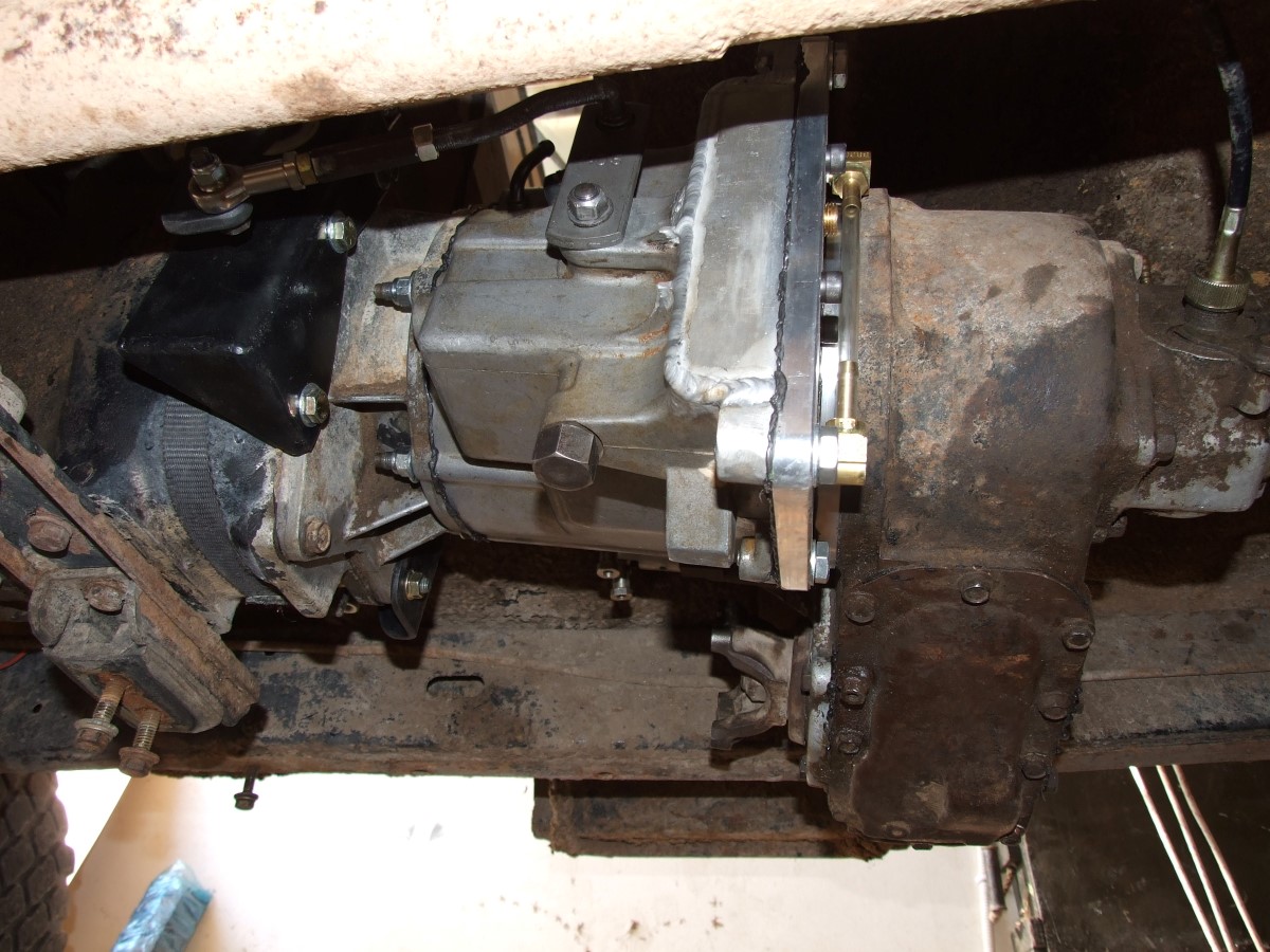

    ' ' . 42 ", ( ...).
    , 300, . .

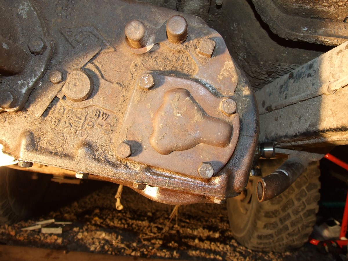

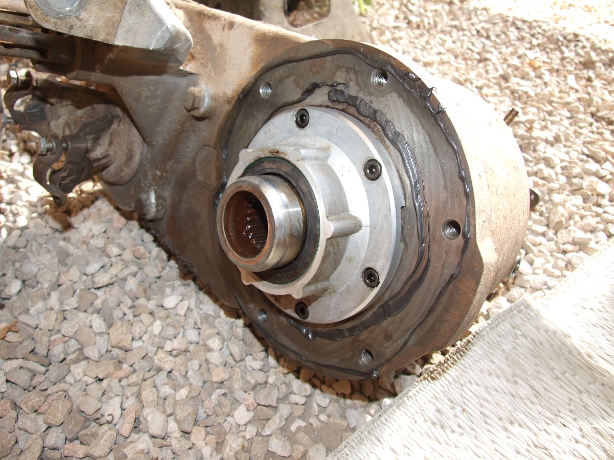

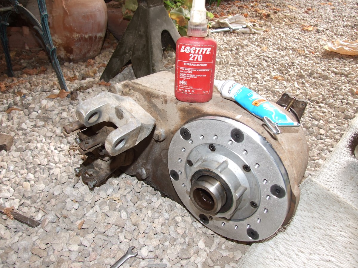

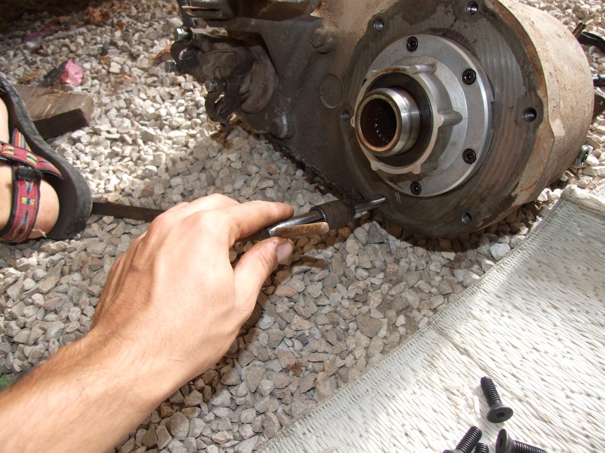

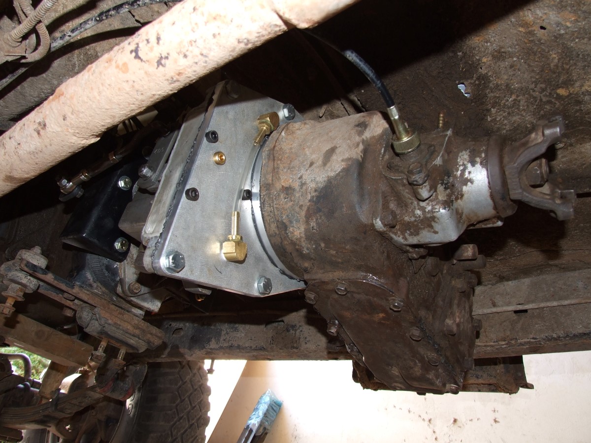

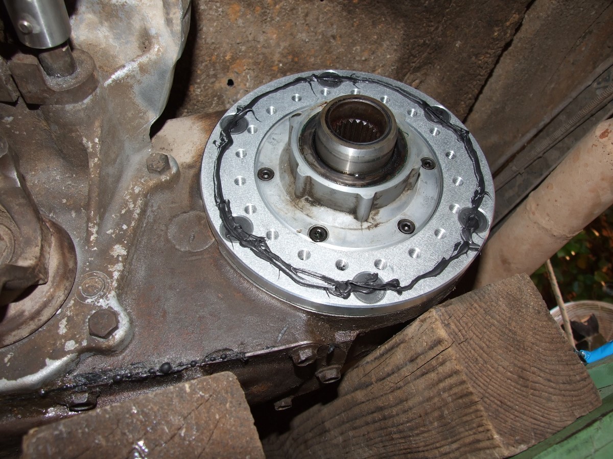

    ' , , RTV , 270 .
    RTV.
    5 . -72 , . " , RTV .
    RTV . . " ', .

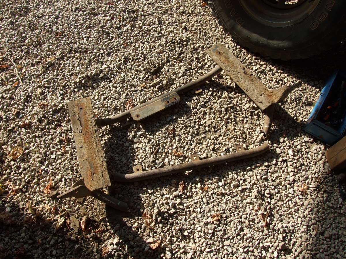

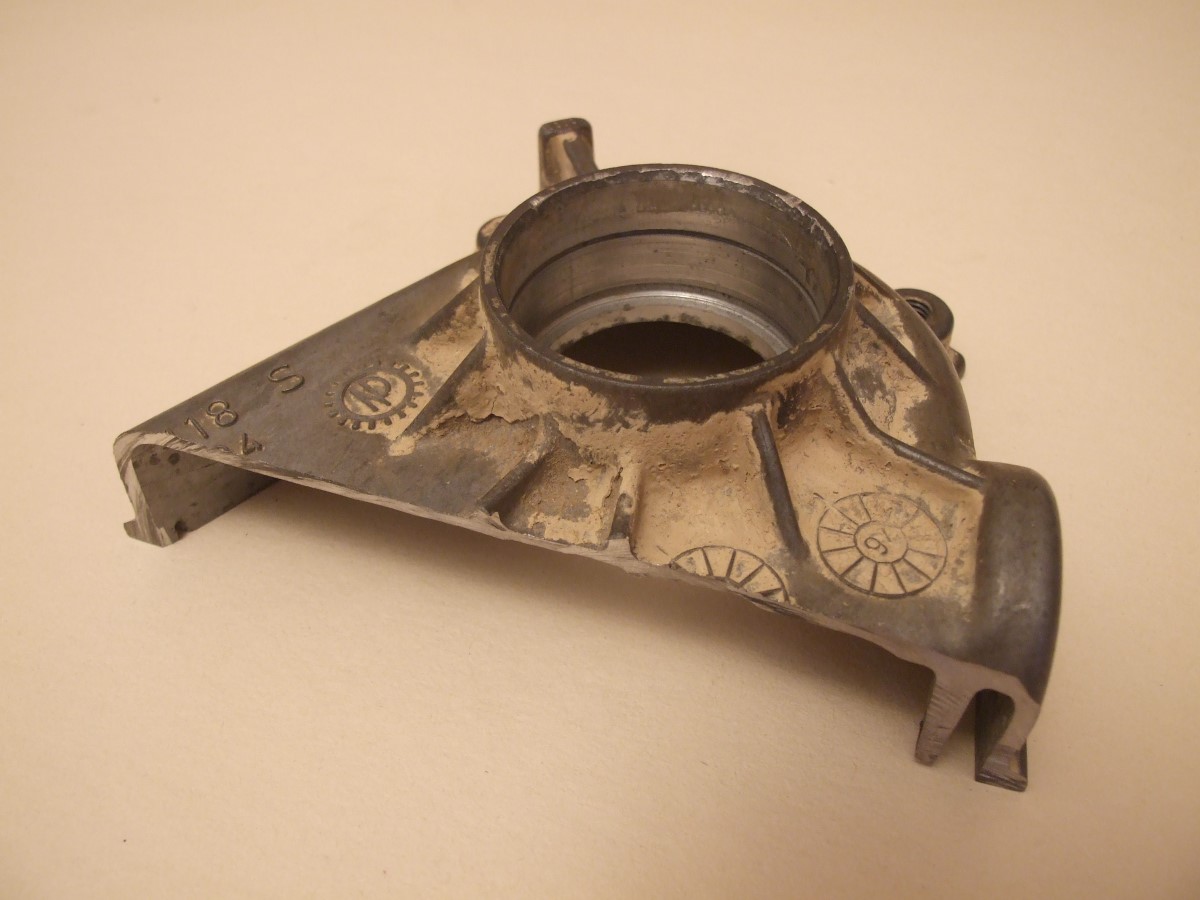

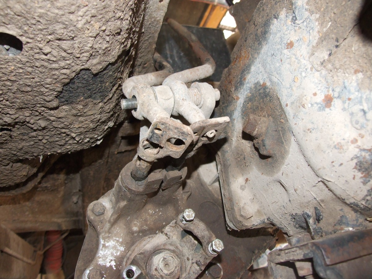

    , -231 .
    , RTV . . , .

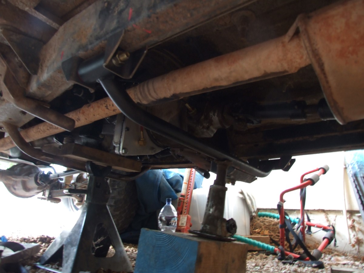

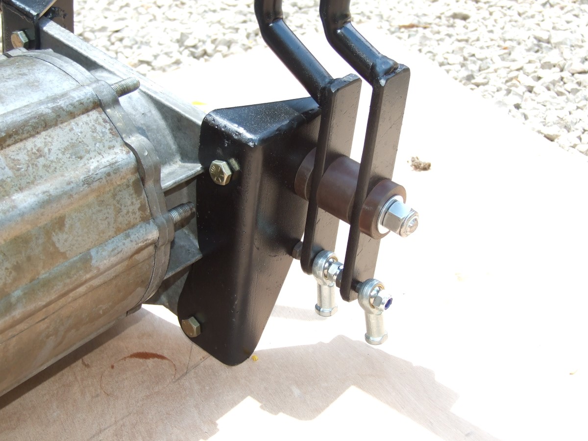

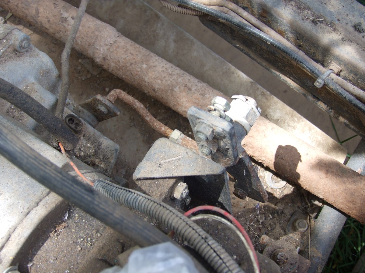

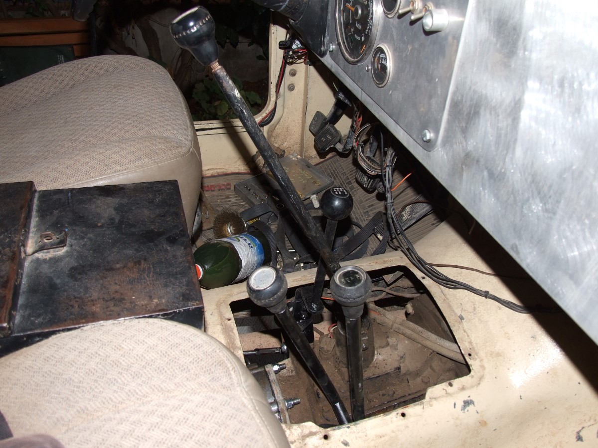

    " "; . 42 ". , . , , . , . .

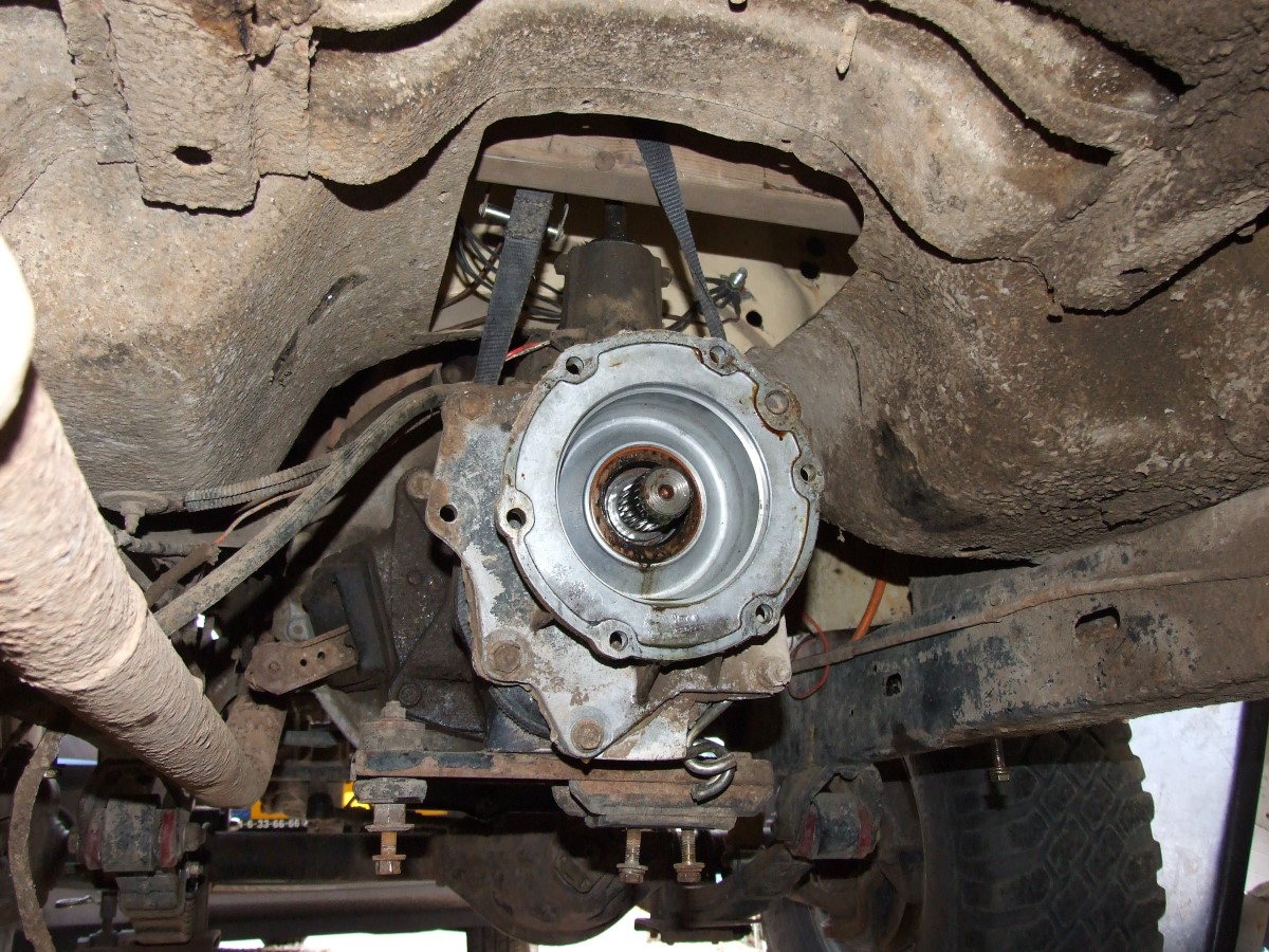

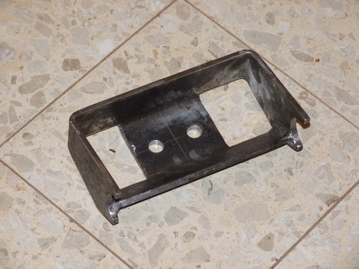

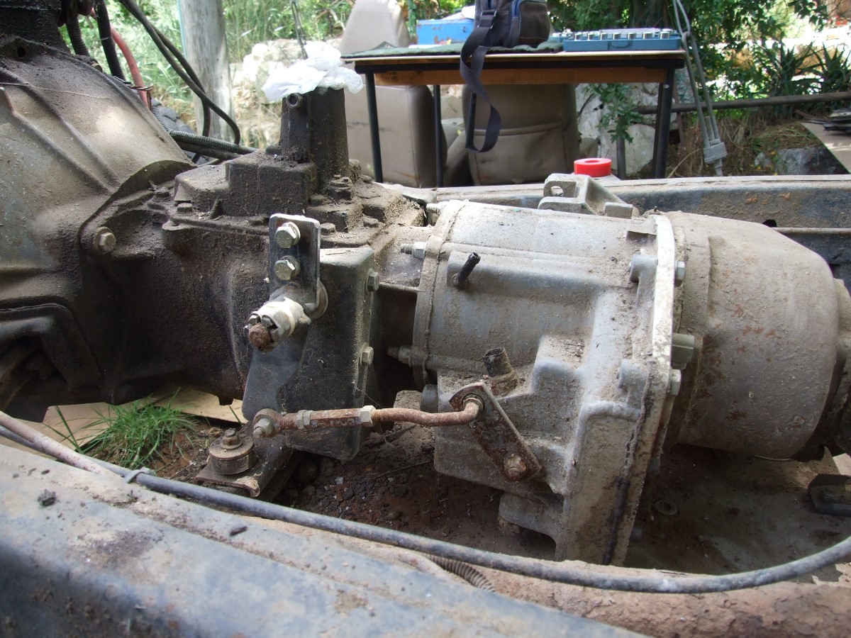

    ( ), . , . . ( ) III. , .

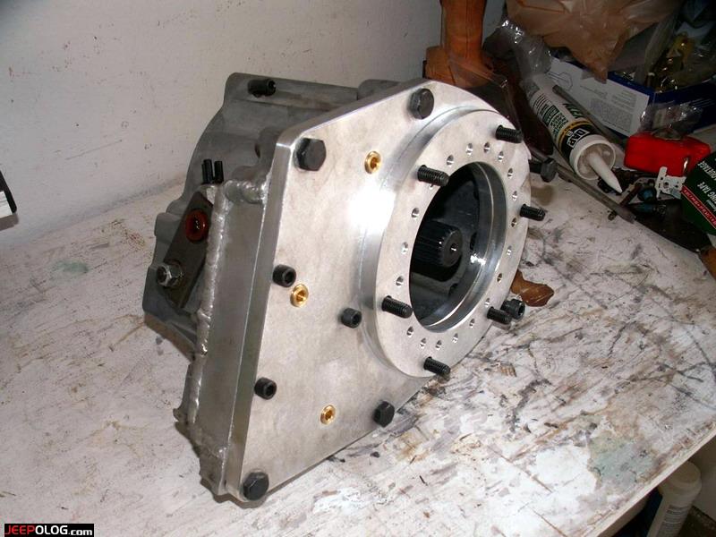

    . , , , -200 ", .

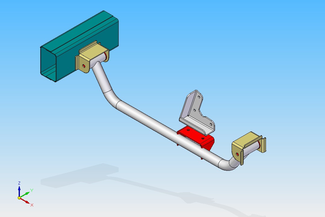

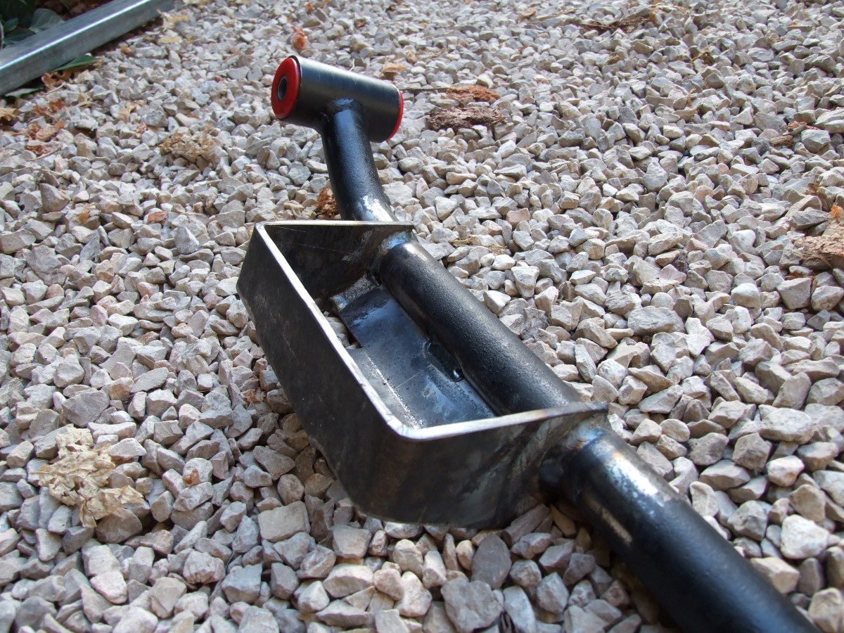

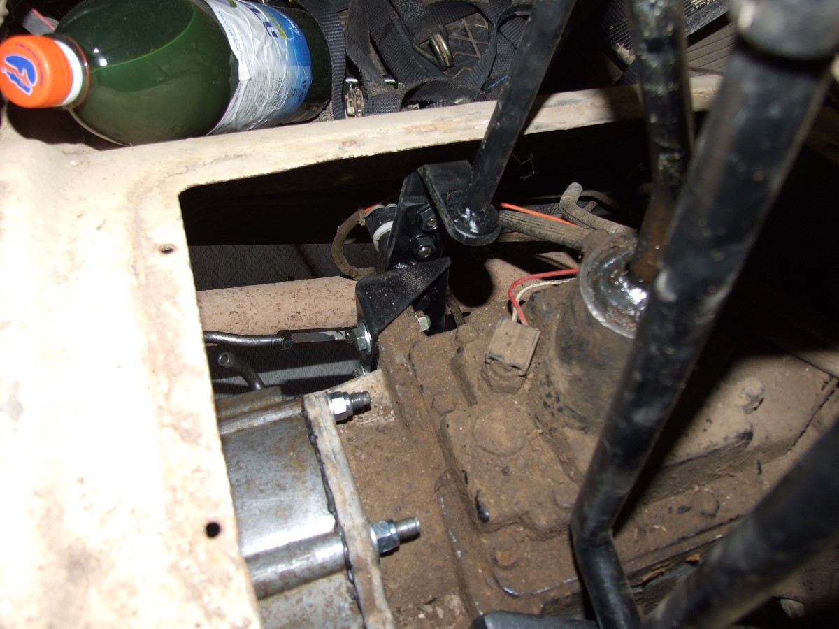

    " SolidEdge.

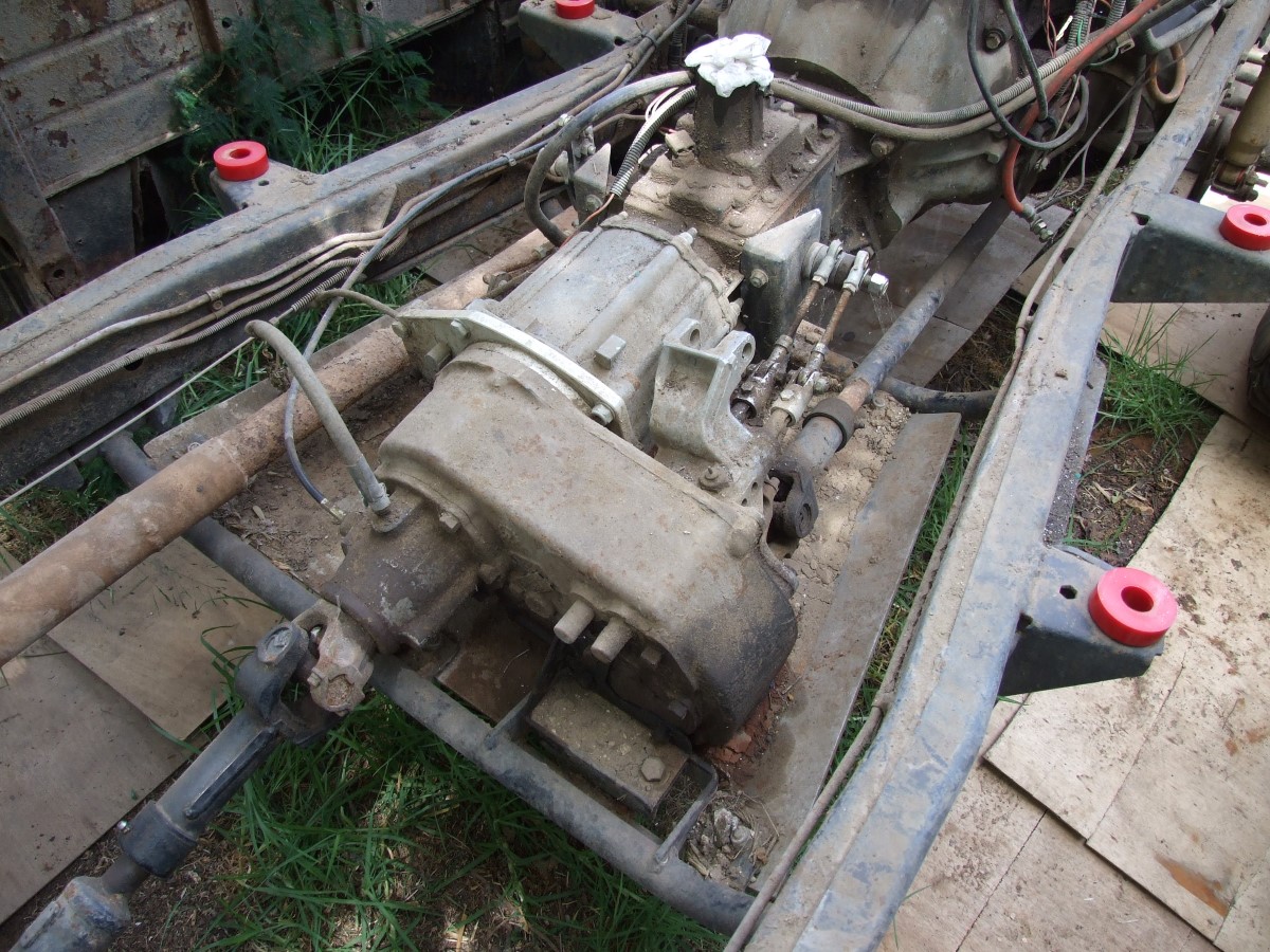

    , ( 2). .
    , 40 1" .
    . . 6061-T6 5 ", . .
    , . . ( -HIGH). , 300 .
    33" , ' , , . , .

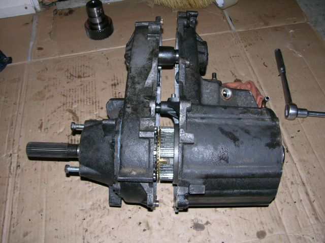

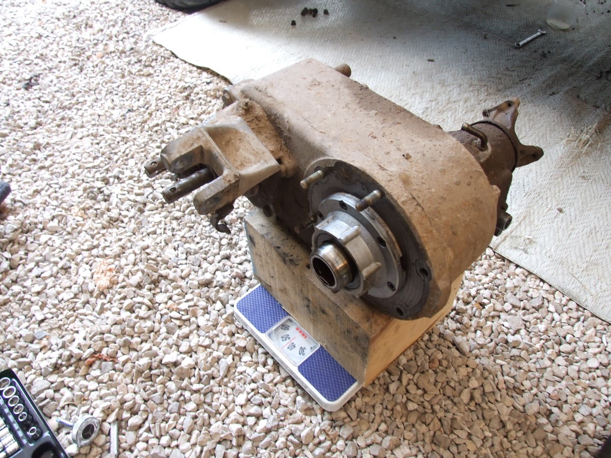

    " $500, $80. 2300 ". 1500 " (, ). 231 , 700 -1200 ". -1000 " . 4200 - 6000 " ".
    - NP231 , . , . . . "" . . , . .
    - . . -RTV , . , , ... . RTV (Victor Reinz), . , .
    - Box4Rocks . " Duffy, . , .
