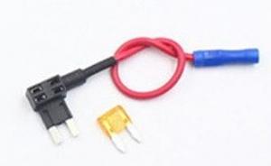

    5-10 , .
    Fuse-TAP Add ON Dual Circuit Adapter AUTO CAR Terminal + 5 AMP Fuse

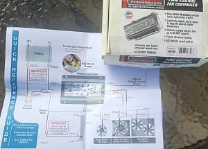

     : 12 ZJ 96
    : ZJ 96 , 5.2L , V8
    : Flex-a-lite 180 Black Magic X-treme 15" Reversible Electric Fan
    , , 50% .
    2 , 2 (12 " ) .
    2 .

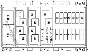

    , 90% .
    "" , 18 - ( )
    , , 18.
    - , 100 .
