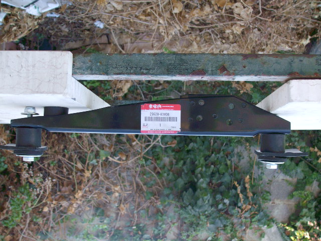

    88 2.25 low. . , , , ( ) . -4*4*2.5 ". /?

    4*4 " -2 " . . , TRAIL GEAR -30$ . . .

    , . / :0.5-1 " , , -case .

    . ( ) 3- / .

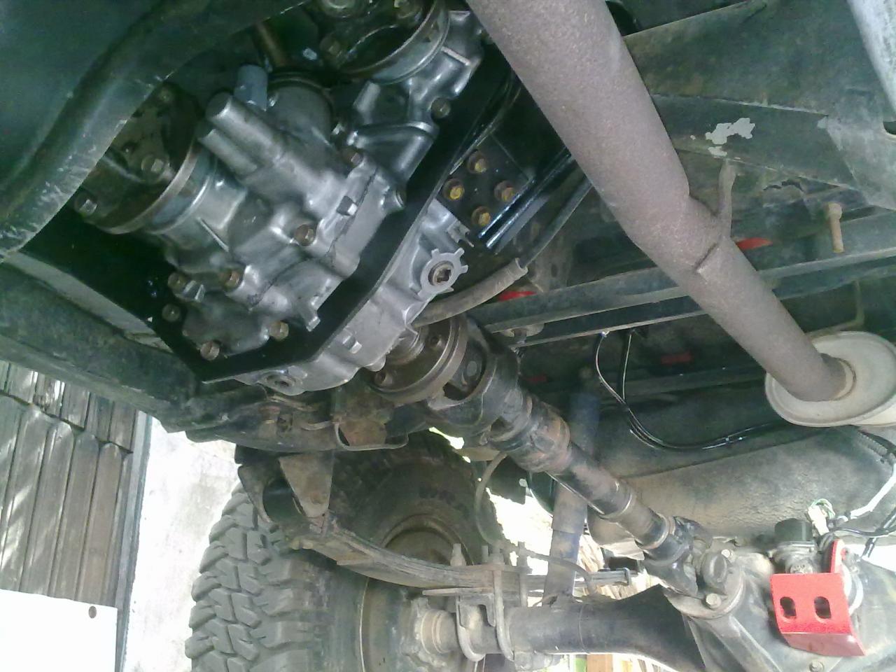

    , 6.5 ?
    , 6.5 ( , ) .. , ..
    http://www.jeepolog.com/forums/attac...9&d=1281549729
     's Avatar
    Apr 2007
    1,138
    " , 6.5 ? "
    . 5.14 . -6.5 6.5 -5.14.

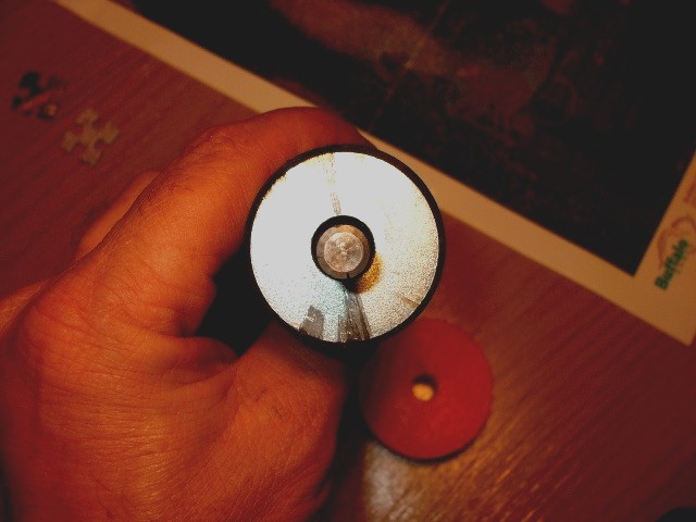

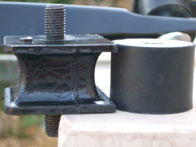

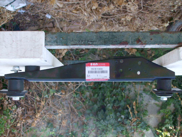

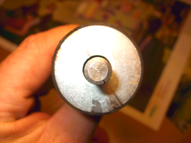

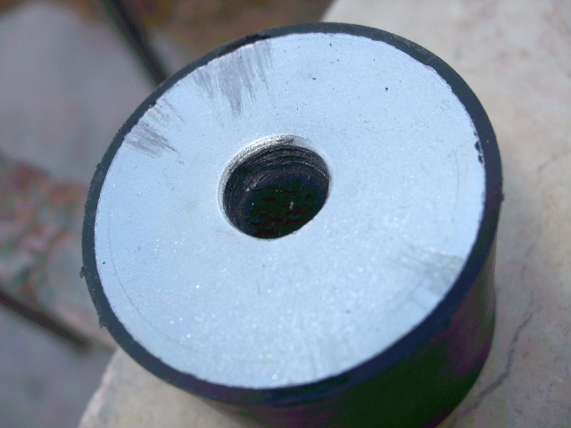

    , OVER-KILL .
     's Avatar
    Apr 2007
    1,138
    , (" ) . " , 4-5 " 8 " .
    shore hardness 10" +- 1-2 " " . case. case .
    / , -low / -high.
