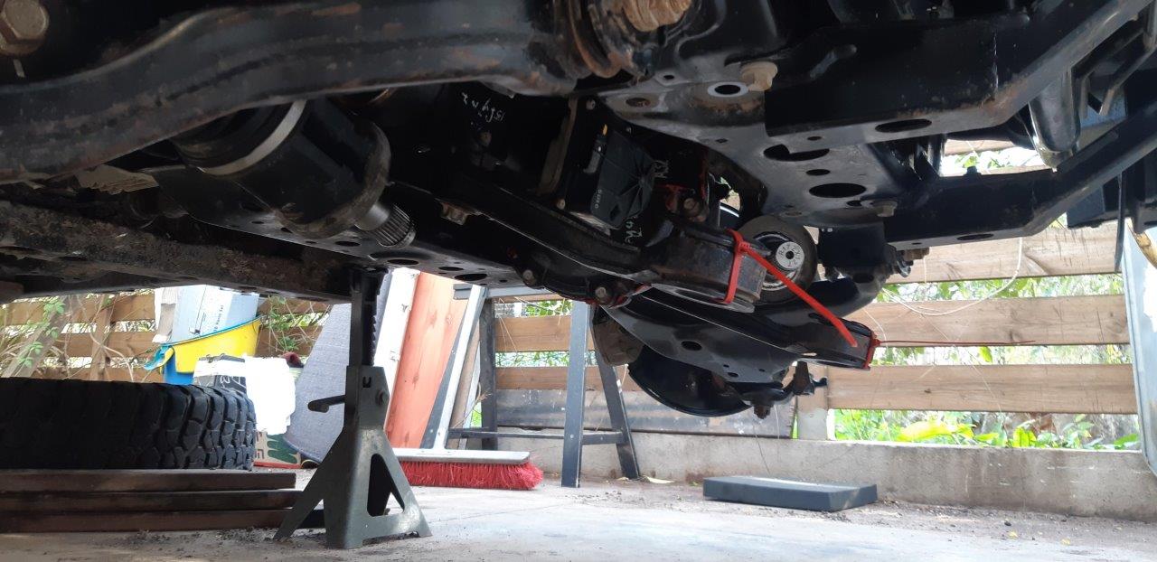

    2005 8 ' "" (Clamshell). , , LOKKA . , , Revo 4X4 , .
    . , ' . 2015 , , , 4X4 "-". .

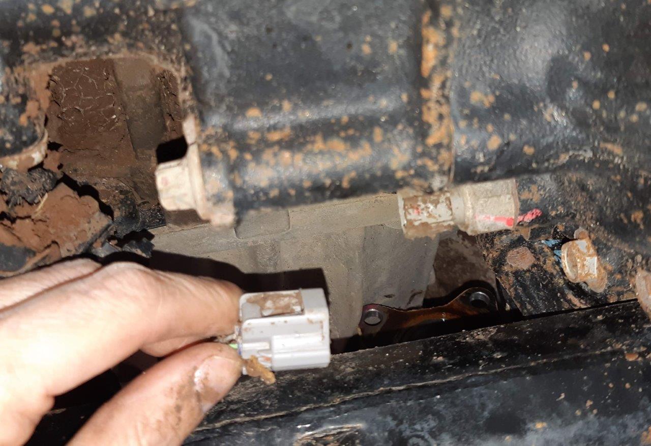

    , . , , . - . "" - Front Differential Tube assembly. , .
    LOKKA . " 8 (Revo) LOKKA-TOY-FO-960. " 7 (Vigo) LOKKA-TOY-FO-959. , " .
    7 8 , .
    120 150, Part-time. , LSD. 120 '.
    LOKKA , 327 1,900 , , . .
    • . 12, 14, 17, 19, 21, 22.
    • 1/2 , / / . .
    • - Feeler Gauge .
    • 6 "
    • ( 242 )
    • 12 "
    • 10 "
    • RTV
    : 10 ". , , . , / 2 .
    . C . ( ) . , ! .
    C , .
    : . 14 ". .
    - : ADD ( ), , ( 12 ") .
    ADD, 12 " , :
    (4) : , , . (3) 12 ". .
    ' , 12 " . .
    : . "" . 4 E14 . .
    , RTV ( ). / , , , , .
    . C . , (Stub axle) ADD. - - .
    : 2 . . . .

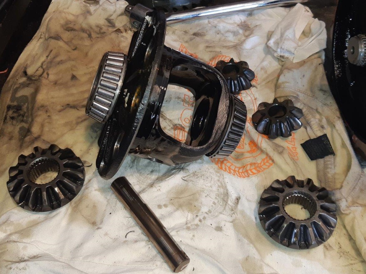

    () 6 " - :
    - , . Thrust washers , !
    : ( , Axle gear), ( - Cam gear), , ( 4 , ). ( ). :
    - + ( Thrust washer - !), 0.15 0.5 ". , - 4 . ( ) - 0.2-0.25 " - .
    , . 3.7 4.2 ". 3.7 , .
    , 0.5 , 4.1 , . , ' , . , . thrust washers .
    , , 97 -.
    . . RTV ( ) . ' ", . .
    10 50 -. .
    , 12 , ( , , M12 ). !
    130 , 110, 110. , (!) .
    : . , C . .
    , 160 -. , . , .
    16 " . 1.65 GL-5. . .
    . , . 10 " .
    , , , , '. , . , 4X4. 4X4, , , . . , 4X4 , ... . , - , ...
    ... , . , . 4X4 , . . . , , - . LOKKA !
    : 8 ' "" , - '? - , . . . "" , . , ... !
